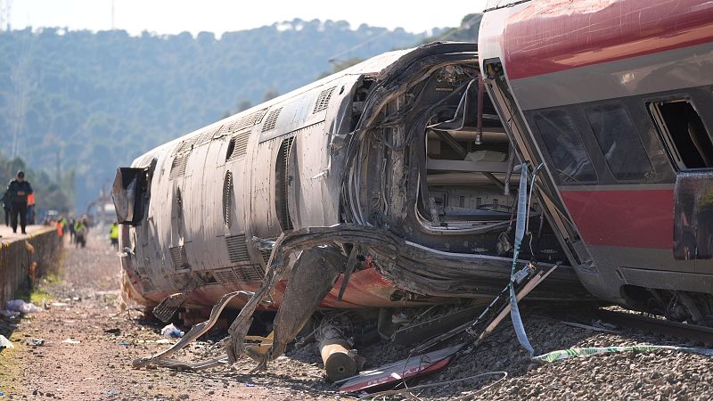

It has occurred to me that a) there seemed to be a big chunk of rail missing and what looked like brittle fractures similar the the rails we saw chopped up by the on-track machine in https://www.railforums.co.uk/threads/steel-rail-is-it-not-worth-recycling.296411/page-3#post-7603784
b) upthread there was a comment that one wheelset was not yet accounted for...
so something that could explain it is a hammer-blow from a big bit of disintegrating wheel which knocked a chunk out of the rail, leading to derailment of the train, then a glancing blow to the more modern train passing in the other direction which impacted the rear 3 coaches most.
Mind you the condition of the track seems to be looking more and more of a problem.
The photograph in post 91 shows a railhead protrusion. If that was sufficient to lift a wheelset, I assume a hammer blow would follow?

I've seen what a bogie that has come out of it's pivot and rotated 90 degrees and become trapped by under carriage equipment can do when it hits rails that are part of point work. And that was on a 25MPH line...
The photograph in post 91 shows a railhead protusion. If that was sufficient to lift a wheelset, I assume a hammer blow would follow?
Maybe, but if wheels are flying and then landing, where they land and make contact with the rail, there will be a clear indentation in the top of the rail. That's often visable on the U.K. network where the ballast under sleepers is insufficiently packed at fishplated rail joints.
If nothing is done, eventually it will cause a worse defect to develop.
Visual inspection, ultrasonic testing (non destructive testing - NDT) or special track monitoring trains should pick up this kind of problem.
It will have lifted the wheelset slightly and there would have been a series of hammer blows in reducing magnitude as the wheelset and primary suspension settle back down - giving the appearance of vibration.
In the photo (all from the left hand side) available at that time you could not see the trailing bogie on the rear of the 6 carriage of the Iroyo train because of people or objects (including lots of ballast) in the way. From more recent photos and videos it is possible to see the bogie is attached and wheels are visible (and where they should be) on the both sides of the train.
RTVE (who were invited on site) have a close up video (from ~4m) of the right hand side of trailing bogie of vehicle 6 which shows the bogie and wheel sets looking in remarkable good condition for what they have been through.
They have been very careful to make sure the vehicle number is visible in the video and start with an introductory panorama so it is obvious it is the trailing bogie of coach 6.
Screen grab of right hand side of the trailing bogie of coach 6:
The bogies and wheelsets of the Renfe Alvia train didn't all stay attached.
