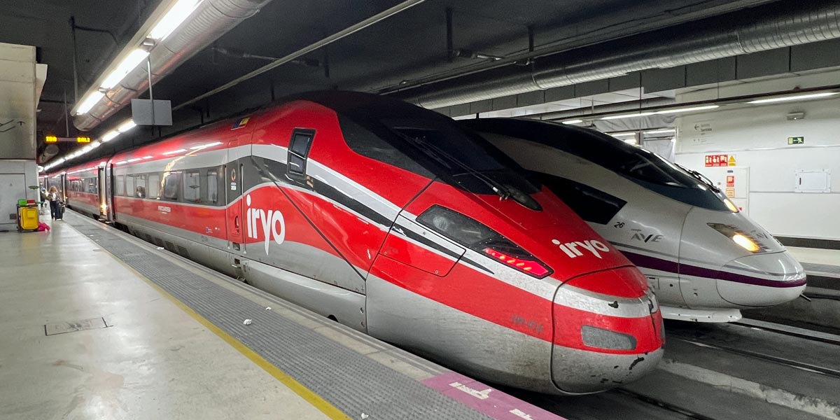

Iryo uses the Frecciarossa 1000 trains, the same type as more widely used in Italy.

The Iryo train would be a Hitachi-built unit similar to the Trenitalia Frecciarosso 1000 used on high speed lines in Italy.

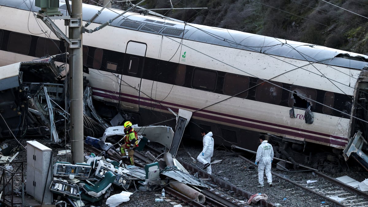

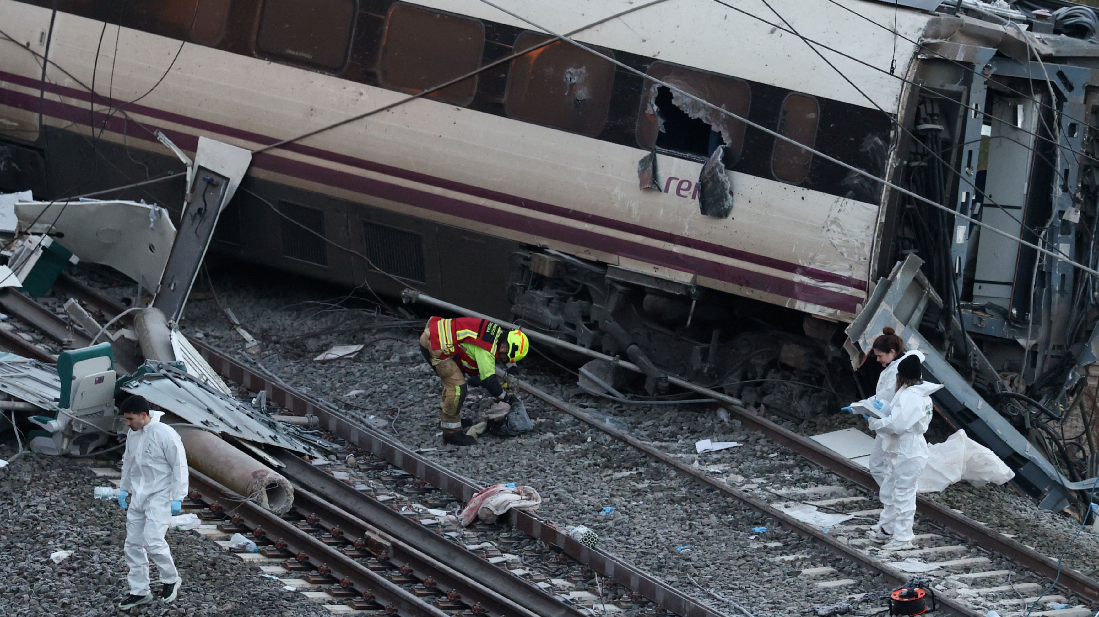

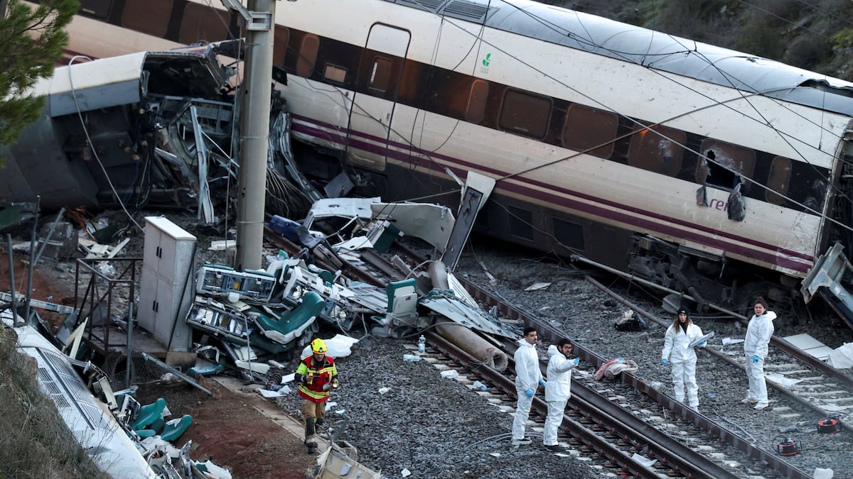

From what I can see, the first two carriages of the Alvia train have been destroyed.
Utterly horrific, and RIP to the victims. The death toll is now up to 24, and there are 15 people seriously injured in hospital. It's not quite clear, but it seems that five of them may be in very serious condition.
From what I can see, carriages 6/7/8 of the Iryo train derailed, and then the Alvia train smashed into them. It seems that it was truly horrific timing, and the correlation between the carriages derailing and the arrival of the Alvia train is why the Spanish Minister of Transport has said that the accident is incomprehensible. The accident happened here, so it seems plausible that something went wrong with the Iryo train after it went over the crossover.

From this photo of the Iryo, I too am struggling to work out the impact sequence bearing in mind the Alvia is nowhere to be seen. If one posits that the Alvia impacted carriages 6 and 7 of the Iryo, as it is fouling the other track, you’d expect it to derail away from the centre and be somewhere in the foreground.

What I see is the Iyro partially derailed with the rear two cars protruding toward the opposite line.
A few hundred metres south I see a large section of obliterated tracks affecting both sides.
And a few hundred metres south of that I see the Renfe in a ditch.
I don’t see any evidence of the trains colliding. Perhaps close ups of the protruding Iryo coaches may show scrapes/paint transfers. But the part of the Iryo train that would likely be involved in any impact with the Renfe looks largely intact.
