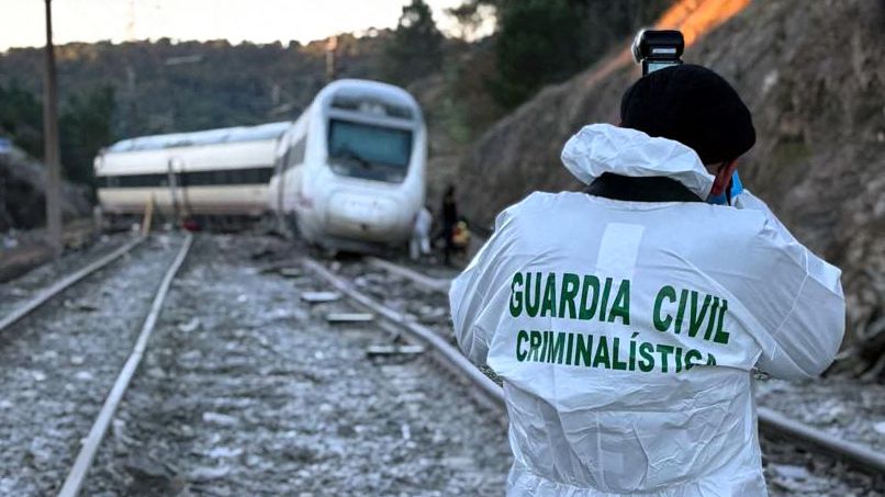

This website shows this picture.
The lack of any other damage around that site makes me suspect that could be them photographing the potential cause. Pure speculation obviously. The aerial footage shows very extensive track damage around the vehicles.
Looks like a very very nasty crash where the layers of cheese (including the onces affecting the consequence) lined up perfectly.
