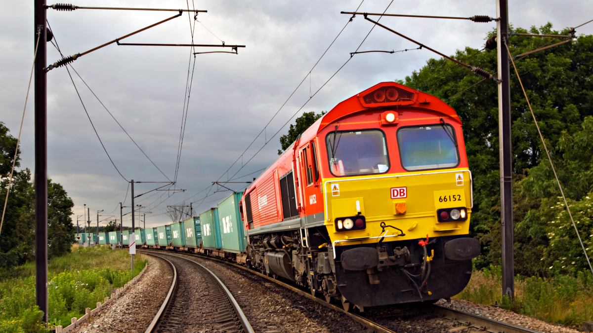

I suggest a lot of the argument on this thread has not paid enough attention to freight. Very different requirements to occasional, light passenger trains on branch lines.
Can we really believe that the rest of Europe has got this issue entirely wrong?
Spent some time in Germany recently and more than 50% of the trains passing (on a busy line that also carries many ICEs and local EMUs) seemed to be freight, often long container trains, travelling fast, at maybe 10 minute intervals. Surely the present state of battery tech is some long way away from being able to power that sort of traffic?
There is also the point that with road traffic (HGVs) still diesel the railway ought to be taking the opportunity to grab more freight traffic and grow its market.
Of course it's insane (in green terms) for electrification to cost so much - and even worse, for Government to allow freight traffic to be put off from using electric traction when under the wires by high prices for electricity. Correct sums about costs and benefits - including environmental ones) have not been done. Oh yes, of course, this is the UK ....!!
Use of BEMU'S for passenger service doesn't rule out electrification for freight. Indeed if the programme is well thought out a lot of the necessary lines for freight could form the basis of a core network for both electric and battery services.
You can't really compare the situation in Germany as most lines would have been electrified before battery technology was even remotely similar to now.
Looking ahead battery technology will play an increasing part in converting services to electric operations but quite a bit of route mileage will still be electrified.
A core network of main lines electrified might see Bristol to Birmingham, Birmingham to Doncaster, Basingstoke to Reading, Didcot to WCML etc which would facilitate a lot of freight moving to electric operations particularly with last mile battery capability whilst also facilitating conversion of many additional services to BEMU operation.
Use of BEMU'S will increase the BCR of future schemes massively by extending the area covered at low additional costs.
Sounds a bit like the WCML. Any line carrying 6tph freight throughout the day would pass the test for continuous electrification. But there are precious few of those in GB that meet that level of use.
Even the Felixstowe branch only carries around 1tph freight, with an operational constraint of 2tph each way.
