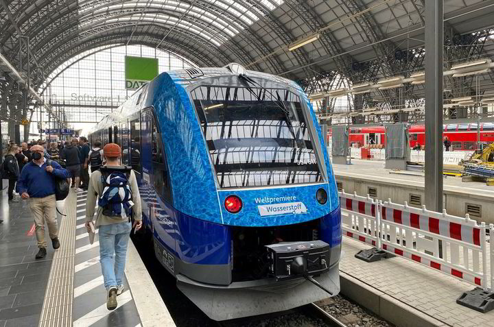

It appears that Germany is making some progress on this even if there are teething troubles:
The main trouble seems to be the location of the fuelling facility and the delays in actually delivering the new trains to the operating company.
I can't see this is worse than the difficulties experienced introducing diesel and electric trains into service back in the 1930s-1950s, where breakdowns were routine and steam often substituted.
