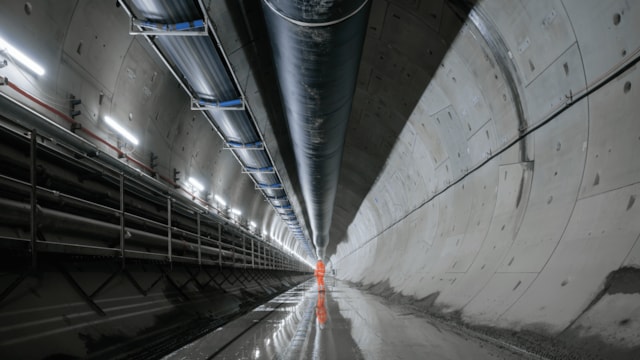

There are a number of bored tunnel segment plants around the country, some remote such as Isle of Grain, Hartlepool and Avonmouth, and some at more adjacent sites eg Denham, for the Chiltern tunnels and Kingsbury in Warwickshire. I think the latter will be nearest Bromford. It would be interesting to see a map showing all the locations across the country, and which sites they feed.
There are also the different types of concrete precast units used in the green tunnels which are cut and cover. I think they come from Stanton in Derbyshire.
The segments from Grain are transported by rail. For most of the year this happens in darkness but I've managed to film them a couple of times in reasonable light due to the long days at this time of year. The trains run from Grain to West Ruislip, pretty much daily. They are pictured here running through south London.

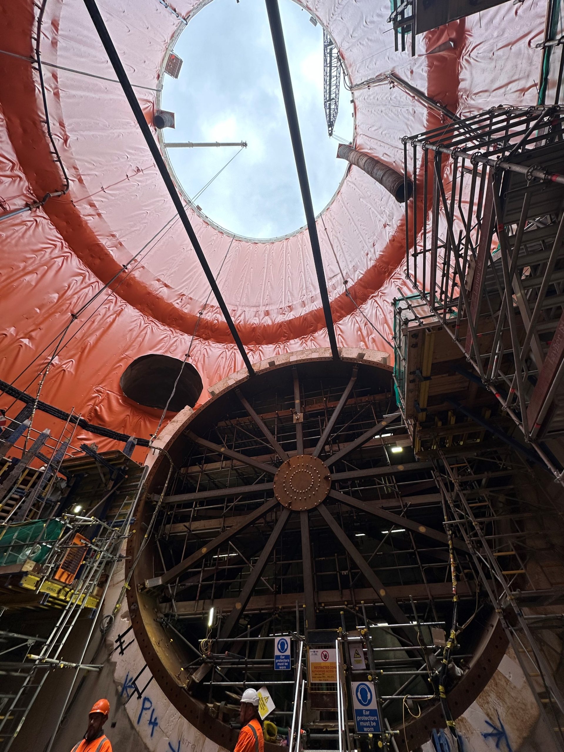

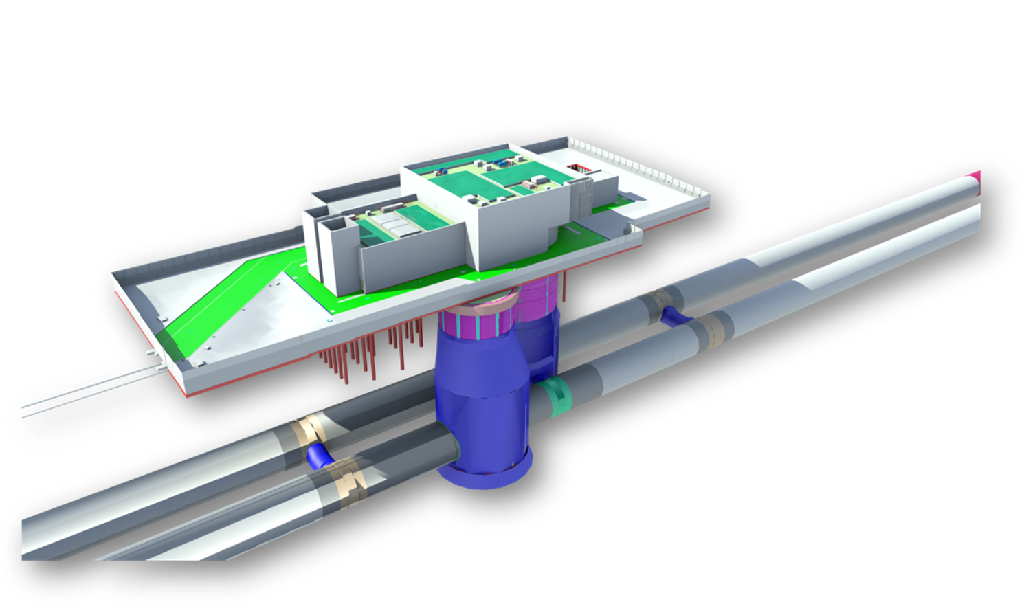

Green Park Way Vent Shaft:
There are four TBMs that will arrive at this shaft: two coming from West Ruislip, boring the 8km Northolt Tunnel West, and two coming from the Victoria Road Crossover Box boring the 5.5km Northolt Tunnel East.
The complex design of the 45m deep shaft involves a purpose-built can to provide a watertight environment when the TBMs eventually arrive for withdrawal.
They will perform some very complex engineering there:
The steel can in the shaft, manufactured in Sheffield, will provide a steel reception chamber to ensure the tunnel is fully sealed prior to the removal of each TBM. It has been built in parts and shipped down to the London site.
The cradle for the can is installed first to the bottom of the shaft. This will provide a stable foundation for the steel can.
Then the steel can lid will be installed and welded to the rim of the tunnel to guarantee water tightness.
According to schematics made by SCS for HS2, the limited space at the site and availability of cranes means the can will need to be installed in limited segments, lowered on to the cradle and then bolted together.
When all the can segments are in place, the steel can lid will be pished back against the can with a hydraulic jack system where maximum movement of 0.1m is expected.
After relevant supports have been removed, the can will be filled with a “suitable fill” and undergo a pressure test. If that test is successful, it will be depressurised before the first TBM arrives.
The TBMs will make their way towards the site and as they approach will extend hydraulic arms to the steel can lid. The reception chamber will then be opened and the machines will be lifted out. HS2 and SCS JV representatives could not confirm the precise method for TBM extraction because of the complexity of the operation.
The complexity had led HS2 and SCS JV to create digital rehearsals in 4D where renderings of the TBMs, the tunnels and the shafts are pictured moving through time.
All four TBMs will arrive at the shaft during 2025.

Here's the HS2 announcement of the half-way point in the Northolt tunnel being reached.
HS2’s tunnelling team are celebrating completing half of the 8.4-mile twin bored Northolt Tunnel underneath London.
Four tunnel boring machines (TBM) are being used the complete the tunnel that will carry high-speed trains between HS2’s super-hub station at Old Oak Common, west London, and the outskirts of the capital at West Ruislip.
The machines will excavate 16.8 miles of tunnel overall – two bores over the 8.4-mile length – making it the second longest tunnel on the new railway after one recently excavated beneath the Chiltern Hills.
