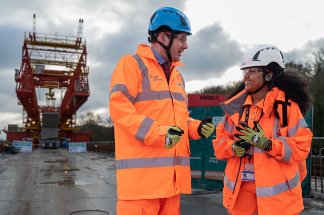

Rail Minister Huw Merriman had a walk along the completed section of the Colne Valley Viaduct today.
It was reported that 141 segments out of the 1000 needed have been installed, so that's 14% complete.
With 56 piers/spans to do, that equates to about 8 span sections complete after 7 months work (with pier construction well ahead of the spans).
With a 2-year completion target, the rate needs to increase markedly.
The minister talks about the "spectacular views" that will be visible from HS2 trains on the viaduct.
Hopefully the view will not be impeded by the noise barriers that will be erected.
