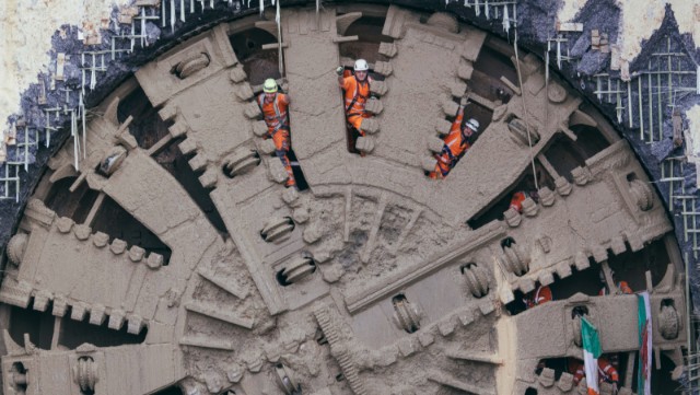

Florence is through.
HS2 have announced today (via BBC South Today at lunchtime) for Florence's breakthrough. I did wonder, looking at the video, why the cutterhead was just behind the retaining wall face. I guess that wall broke up before it was meant to, possibly because Florence didn't quite stop in time.
So, if HS2 need to show a breakthrough on video, how will they do that? Quickly build a new one? Edit in footage from previous breakthroughs?
Grimsby town
4 Apr 2011
852
It was actually just a painted mural of the TBM cutter head. From the drone it was difficult tell that but when you see its a pristine blue colour and compare that to the actual TBM breakthrough, it's pretty obvious. Still it fooled me.
21,897
I don't think the pictures show the Rail Minister and HS2 Ltd top brass in attendance, but it must have been a coordinated event with quotes and seemingly all the TBM's several crews in attendance - a real orange army.
From what I can see the tunnel was completed ahead of schedule, which was planned for 3 years at 15m/day.
Florence actually took 1020 days (2y9m) at an average of 15.75m/day.
Cecilia should improve on that, as it started 6 weeks later and has about 2 weeks to go.
I should think HS2 Ltd will be well pleased with this as it's one of the most significant construction tasks completed in good order.
Presumably the logistics of the cross-passage construction (they were quoted as being past the half-way point recently) will be simpler now they have access from both portals.
We don't know the costs of course, and there's the blot of four sinkholes to account for.
Obviously you're right, all Florence's face paint got scratched off ages ago, so the blue we see must be Muriel. But comparing the video above with HS2's, the dark ring around that looks similar, so that part of the breakthrough did happen in advance. But then "breakthrough" here is not just an engineering process, it's a stage-managed event.
