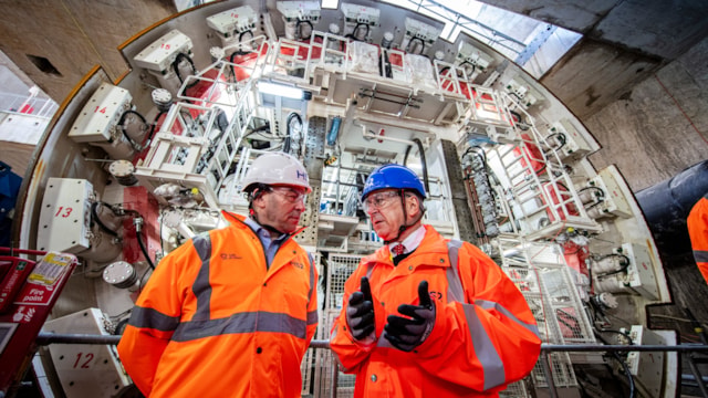

HS2 press release on Euston TBMs
Engineers have begun assembling two giant tunnelling machines that will dig the final 4.5 miles of underground high-speed railway – carrying HS2 trains into the heart of London.
Weighing an incredible 1,250 tonnes, each of the tunnel boring machines (TBMs) will launch from an underground box at one end of the project’s Old Oak Common station. They are expected to take around one and a half years to reach the railway’s final southern terminus at London Euston.
As well as taking passengers closer to central London, the extension to Euston will create additional capacity on the new high-speed line, allowing more services to run to more destinations across the Midlands and the North.
Arrival of the line into Euston is also expected to trigger a transport-led regeneration of the area – unlocking opportunities for thousands of new homes and jobs.
In keeping with tradition, the TBMs have been given female names after prominent women in history. One machine is called Karen after Karen Harrison, the first female train driver in the UK who was based out of Old Oak Common depot. The second is named Madeleine, after Madeleine Nobbs, the former president of the Women’s Engineering Society.
The unveiling of the TBMs – the final set to be launched for the railway between London and the West Midlands – marks another significant milestone for HS2.
