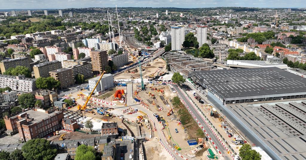

A new drone video showing current status of Euston approaches has been posted, rather looks like an abandoned building site in places. Negligible evidence of anything being constructed At current time.
What a wasteland. What a waste. Welcome to GB.
There are annual government wide capex limits hence cash is being prioritised elsewhere on HS2 and across government.
The next major stage is reliant on the utilities firm diverting the utilities from Hampstead Road to Granby Road (always one of the slowest bits on any NR bridge job) and HS2 widening the Hampstead Road alignment to divert traffic so the existing carriageways and pavements can be dug up (the tram rails were tarmac'ed over and there is a lot of history to remove under the surface) followed by piling and new bridge deck construction.

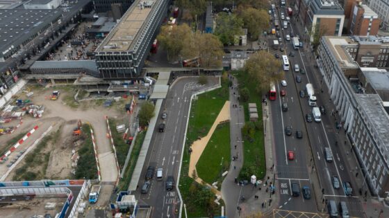

What is happening outside of Euston currently?
The grassed area in front of the taxi rank that was tidied up earlier this year has now had the grass removed (or destroyed) and the black metal decorative fencing has been removed and palletised..
