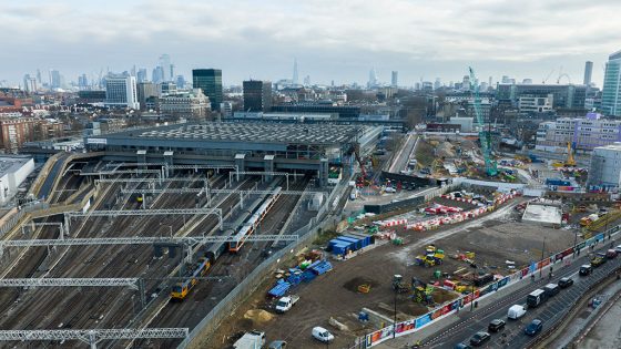

There is a decent article on the Guardian/Observer web site today, about the issues at Euston (and more widely on HS2).
I think there is some guarded optimism that a way through will be found at Euston, but it might need a new government to change the current mindset.
https://www.theguardian.com/uk-news...am-raise-new-fears-over-hs2s-route-and-future
In the vision of HS2 published by the government a decade ago, a gleaming new station should now be taking shape at Euston, with the first high-speed trains to whisk passengers from London to Birmingham just a couple of years away.
Things have not, of course, quite panned out like that. The scars of the early works are evident in the area of central London surrounding the station: the vanished buildings, parks, trees, pubs and half of Drummond Street. Portholes on the hoardings that line the way to the remaining south Asian restaurants allow a view on to a mothballed site where a muddy Euston pond is forming.
The team of contractors – Skanska Costain Strabag – working on the zone leading to the station, which is known as Euston Approaches, make it clear that a pause was never welcome. Its managing director, James Richardson, said: “We have to continue with critical works now – otherwise it would make it difficult, if not impossible, to revive in the future.”
Many of the 3,500 workers here have been redeployed within the firms, but some continue preparing the future tunnels out of Euston, including a giant concrete box where HS2 trains will switch lines to different platforms. More than 1,000 deep piles have been planted in the narrow sliver of ground between John Nash’s historic villas in Regent’s Park and the west coast mainline.
Proponents see the decision to cancel the short “phase 2a” stretch from Birmingham to Crewe as particularly galling, given its relatively low cost and the advanced stage of the works. Congestion is likely to increase around existing bottlenecks once HS2 services start.
Rail leaders are now looking for alternative solutions that do not cause more years of disruption on the west coast mainline. As a senior rail source put it: “A high-level strategic planner might say you will probably come to a conclusion that more or less mirrors HS2.”
