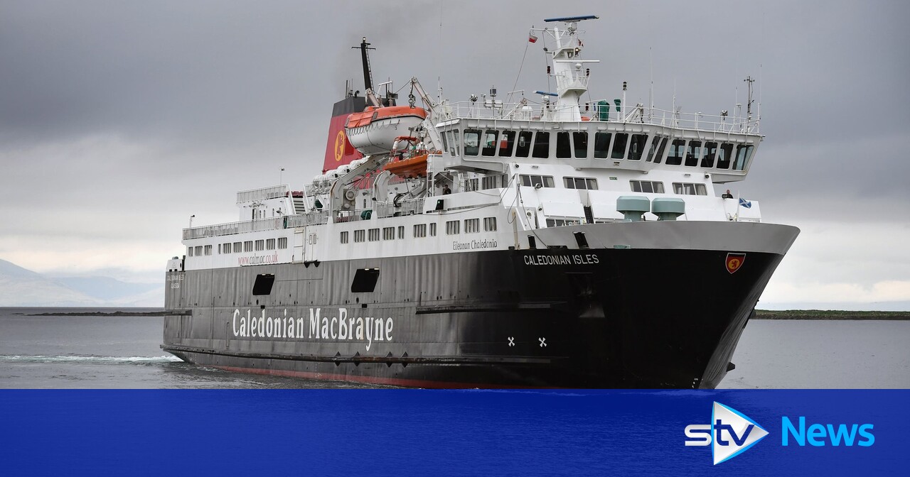

To add some semi-technical detail. Caley Isles, like most ferries is driven by controllable pitch propellers. These spin constantly in the same direction and generally at the same speed, and the angle of the individual blades is adjusted to vary the thrust from full ahead, through neutral to full astern.
These blades are attached to the hub, together making the propeller. They twist in their mounts on the hub, to adjust their pitch, with a rather complicated mechanism of push rods that runs all the way up the hollow propeller shaft back into the engine room, where there is a hydraulic unit then the connection to the telegraphs on the bridge.
This system allows instant control of the ship from the bridge, and reduces wear on the engines. The disadvantage is its complexity, and that many of the critical components are located in the hub, which is both underwater and spinning at several hundred rpm!
It sounds like there is some kind of jam in the mechanism, which is limiting the pitch to only around 15%.
Disclaimer: I'm just a simple navigating officer who hasn't worked on Caley Isles, so I may have some details wrong!
The mechanism sounds similar to the one that caused problems on Hebridean Isles.

Caledonian Isle has returned to dock in Greenock as the issue have still not been resolved. So there will have to be a mass rotation of vessels next week to cover essential maintenance on the Alfred: Isle of Mull moves to the South Uist run leaving the main Mull route with just the two smaller vessels (Coruisk and Loch Frisa); this frees up Lord of the Isles to go to Islay, which in turn frees up Isle of Arran to run Ardrossan-Brodick in place of Caley Isles.

Not the news CalMac were hoping for. It's concerning that they're not even sure if she will need dry docked or not, as it says that CalMac aren't sure themselves as to the extent of the problem. Isle of Mull will do a handful of calls at Craignure on Mull to help things, but it's still going to be a very difficult few weeks.
The worst thing about this entire saga is that it's now very clear that Andrew Banks was right: a cheap Asian ship has been perfectly reliable and suitable for the route. At this moment, I bet there are some people in CMAL wondering why they didn't just go with four of these ships for the Arran run!

Latest update on MV Caledonian Isles is that CalMac are not now planning for her to be available until at least 7th September: https://www.calmac.co.uk/en-gb/travel/latest-customer-updates/customer-update-arran-services/#/
Ardrossan-Brodick, up to 0945, 24 July – the service between Ardrossan and Brodick will operate up to the 0945 departure from Ardrossan on 24 July, when MV Isle of Arran will depart from Brodick to Kennacraig.
No service between Ardrossan-Brodick, 25 July – 7 September inclusive – there will be no service between Ardrossan-Brodick while a return to service date for MV Caledonian Isles remains unconfirmed. We are preparing plans on the basis that she may be unavailable to us until at least 7 September.
Means that once Alfred returns from service the main Arran service will be entirely from Troon for the rest of the summer. At least the other routes should be back to "normal" (barring any further breakdowns), with Isle of Mull going back to the main Oban-Craignure route to Mull.
A further complication though is that Troon linkspan requires maintenance between 8-14th September, so Arran will need to be served from Ardrossan - but neither of the current vessels (Glen Sannox and Alfred) can fit there: CalMac will be desperately hoping Caley Isles really is back by then...

This must surely be the end for her now
Apparently not. The manufacturers of the propulsion system have proposed yet another repair of the existing system or a new one to the latest design, both are being pursued. Lack of dry dock space means she’ll have to sail to Leith.

Correct me if i'm wrong, but wasn't the propulsion system completely renewed about 4-5 years ago? It seems ridiculous that it has such problems already, unless this is actually connected to the ongoing case by CalMac against the company that performed some of the repairs to the hull originally. I know there were some issues with the propulsion system connected to the badly performed repairs, so perhaps it's all interconnected.
Maybe not the end just yet, but getting closer and closer. If they'd known how bad it was at the beginning, I think she'd have already been scrapped and Ardrossan permanently closed. I imagine this is very much a 'last chance saloon' for her now.
