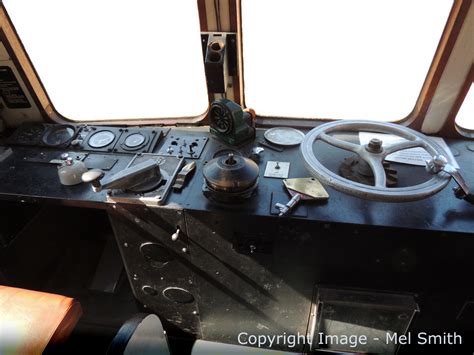

In both cases they were vehicles with a handbrake. In passenger service these brakes would only be used for parking - coaching stock has had to have comntiounous (air or vacuum) brakes since the 1890 - specifically after the Armagh runaway disaster of 1889. The brake coach was, obviously, where the guard rode (siomeone had to be there to operate it) and so a space for the guard was provided, and it was the obvious place to also have luggage, mail, parcels etc so that it could be supervised
"Unfitted" freights lasted a lot longer, and required a brake van at the rear so that, should the train become divided, the rear portion could be stopped.
The brake is the large wheel in the foreground. The wheel is turned to operate a large screw that applies the brake.
DMU cabs had them too
