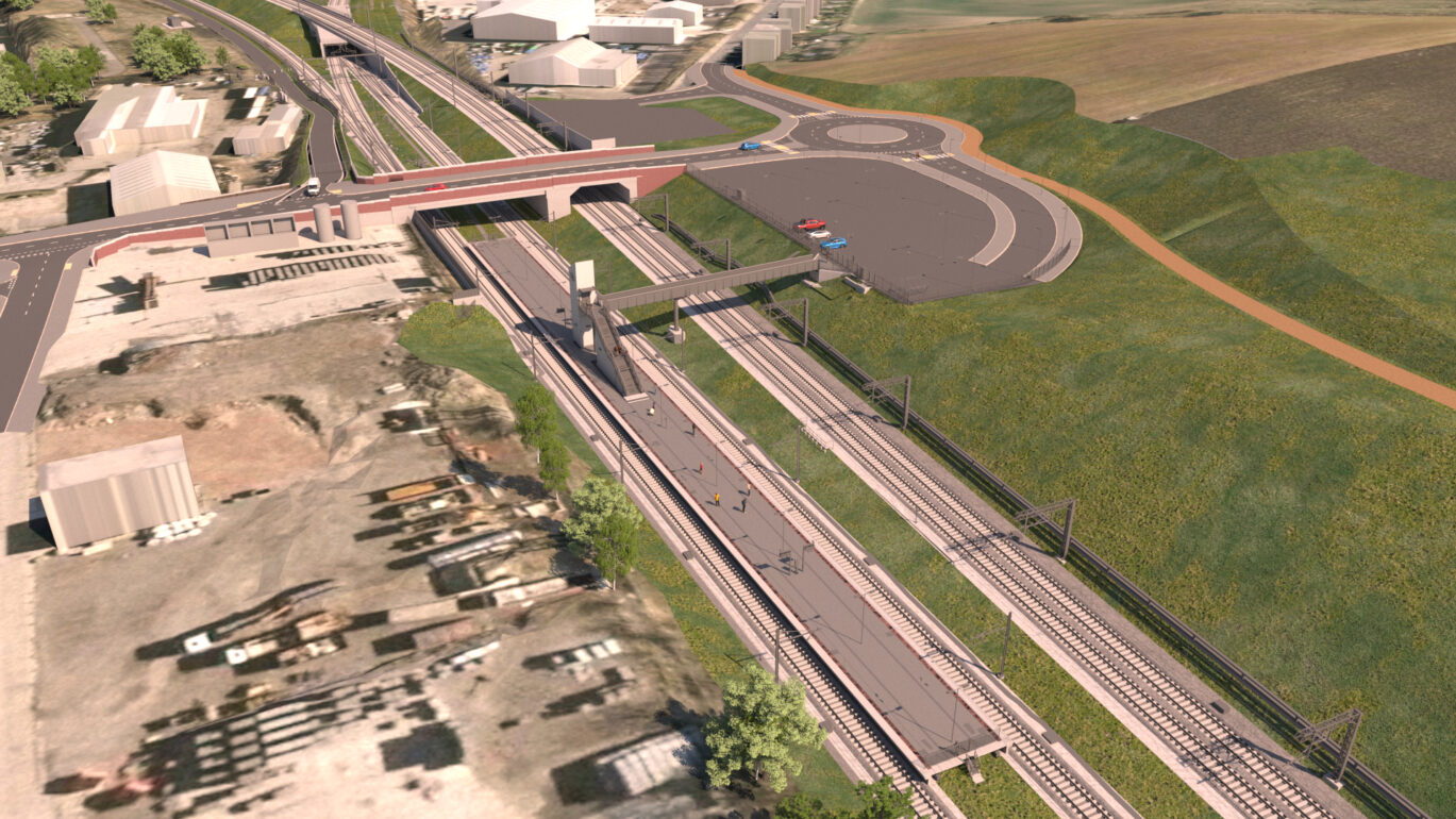

I presume that at the far end of the steel structure we can see the shape of the future grade-separated junction where the slows and fasts converge? The with of the viaduct suggests that the actual turnouts will be on the side closest to the camera though, presumably to avoid needing to maintain turnouts directly on a bridge!
Zwk, the link below should provide a good reference, I look at it often because I still can't see how the lines at the flying junction will gain enough height so I guess you can't really tell from the video that Ravensthorpe new station must be going into a hole!
One reason is to allow slow west bound trains to leave the two track section and wait for the junction at Ravensthorpe to clear without impeding the fast lines.
The fly through video is not very clear. This following image from the TRU website shows it from a better angle. The fast lines pass through the new Ravensthorpe station part way up the embankment. They pass under the Calder road bridge at a higher level than the slow lines.
This is the plan:
The four track section extends another 100m or so north of the River Calder. Not only is this good from a maintenance point of view; it also means the bridge is already fully four-tracked should there be any plan in the future to extend four tracking further towards Dewsbury or Leeds.
The old Calder Road bridge is just in the way of the new fast line route. Once it has gone, then should be clearer.
And the new Ravensthorpe station is going to be right on top of where the current 3 tracks are. It's going to be interesting how the phase the work.
