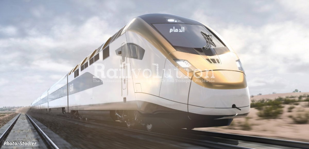

gensets powering traction motors are superior to hydraulic transmissions. Of course, as a bi mode set there's nothing to stop TS stringing some wires up at strategic locations to help with climbing hills.....
The intention is for the whole of the Highland mainline to Inverness to be OHLE electrified around the mid-2030s, but this consideration could influence which sections were wired first. For short bursts of acceleration and hill climbing elsewhere, batteries will be able to supplement diesel output, and will be able to harvest at least some of the regenerative braking energy from long descents. That could help define the battery capacity, i.e. at least capable of taking the entire braking energy (minus hotel load) of the most extreme descent.
If you have to put another engine car, you'd probably be better putting all the engines in one vehicle, using a single (or two) larger engines and move it to one end of the train. We could call it something different, like "power car" or "locomotive"...
New Stadler trains for Saudi Arabia will have end power cars.
On 5 February 2024, Saudi Arabia Railways (SAR) and Stadler have signed contracts for the supply and the maintenance of the Next Generation Passenger Trains for the operation on the growing network in the Kingdom of Saudi Arabia.
The new trainsets will be designed according to latest European and international Standards while being equipped particularly for the climatic and ambient conditions in Saudi Arabia. The units with a length of about 175 m will consist of two powered end cars with diesel-electric power transmission and five intermediate cars, with a capacity of about 320 passengers.
The design of the end cars is derived from the SMILE high-speed trains (referred to as Giruno by SBB), suggesting that the maximum speed could be 200 km/h, similar to the previously supplied SAR‘s CAF trains. Stadler told us that the trains will have a power of 6,000 kW, and deliveries will start from 2028 to around 2029/30.
Some Nordic Express units to be delivered to Norway will be bi-mode with a diesel power car in an 8-car set. Not obvious where in the following renderings, but they might be only illustrating the all-electric version.
