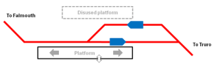

The ideal place for this sort of station is at a passing loop on an otherwise single track line, ideally on a branch line with relatively little through traffic- in other words, where the line as a whole has a capacity limit anyway, and so a single platform design won't make it any worse. Penrhyn station is the best example. Wikipedia has the attached diagram:
The diagram is also found at https://commons.wikimedia.org/wiki/File:Penryn_track_diagram_2009.png#mw-jump-to-license
Dovey Junction also works like this on the "main line" - of course Pwllheli trains have their own platform.
