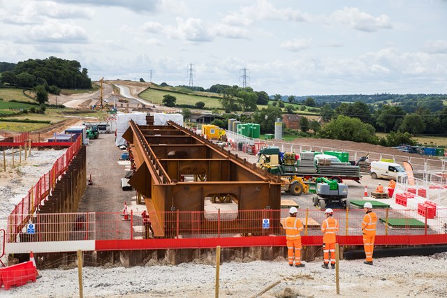

Pictures on the HS2 site of the first steel segments of the Wendover Dean viaduct.
