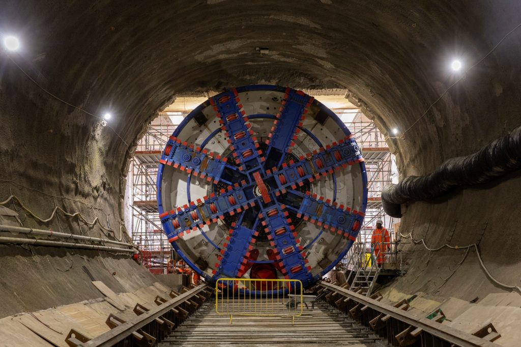

The second Euston TBM has started digging:
Article in New Civil Engineer:
And blog post from site visit:
Including ride through the logistics tunnel:
WWTownEnth
21 Mar 2014
696
Good news…….
