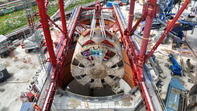

In the first update at Northolt East for a while (for May 2, 14 days since April 18, which includes the Easter holiday period):
Emily is at 5220m (+228m), Anne at 4853m (+10m).
So Emily is moving well and has just 329m to go to completion.
Anne has hardly moved, so some maintenance if likely - 647m to go.

Emily is due to park up at GPW a few rings away whilst they prepare for the arrival, they aren’t quite ready.
We expect to park the machine on Monday and ‘breakthrough’ a few weeks later

HS2 TBM update from In your area map
Anne 5019m with 481m to go, updated 10 May
Emily 5423m with 126m to go, updated 10 May
Some issues with our muck bins, and other miscellaneous TBM issues, progress not as rapid as planned
Estimate is Emily to park up on Thursday night
16/05 - Emily is now parked for 3 weeks
Anne is plucking away at 26m a day
