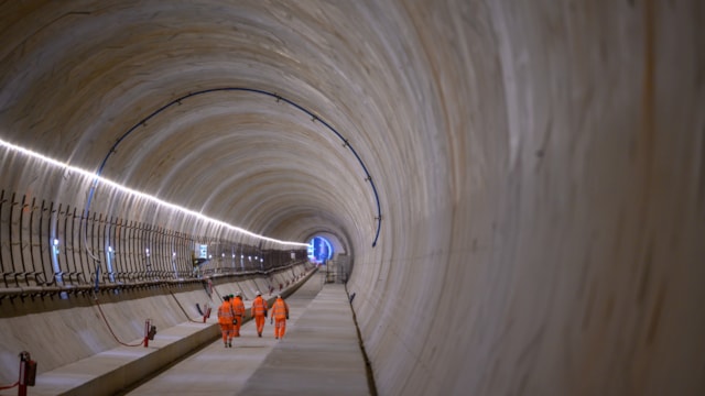

HS2 has announced today that Long Itchington tunnel (where TBM Dorothy finished couple of years ago) has reached construction milestone with vital elements, including three cross passages, concrete finishing works and base slabs, and emergency and maintenance walkways, all complete.
Now just needs fit out for railway.
  • HS2 has unveiled the first twin-bore tunnel on the project to be completed at Long Itchington Wood in Warwickshire.
  • The development sees the completion of features such as cross passages, base slabs and walkways – ahead of the internal fit-out of railway systems which will allow high-speed trains to operate.

Should we be worried that it took a couple of years to complete the civils for a relatively short tunnel? Hopefully the other tunnels will be done more rapidly...
stuu
2 Sep 2011
3,774
No. No point throwing resources at something which isn't urgent. A sensible decision, for once
21,957
A probably pertinent point is when will the completed Long Itchington tunnel, or any other section, be fitted out with rail systems?
That could still be several years away, with the purchase contracts only signed in November 2024 and with no detailed delivery plan made known.
Also Long Itchington tunnels are short relative to the others, and I got the impression the 38 cross-passages for the Chiltern tunnels were being constructed close behind the TBMs.
There's also the progress on the various headhouses and vent shafts to consider in the longer tunnels, not needed at Long Itchington.

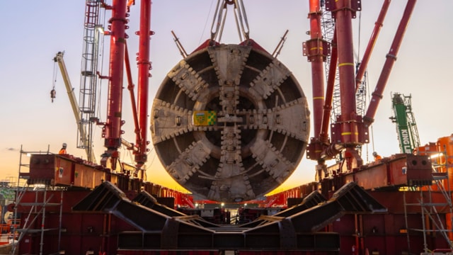

TBM Shushila was extracted from the Greenford Way vent shaft on March 15, after completing its 8km Northolt West tunnel drive from West Ruislip.
Shushila completed its drive in the western tunnel on January 9, so 10 weeks to dismantle the system and complete the lift out.
Three more TBMs will follow the process at Greenford Way later this year, the next very likely to be Caroline in the eastern tunnel around June.

I am interested in why the TBMs are being lifted out vertically. If they have reached the far end of the tunnel, should they not come to the surface of their own accord?
TheDavibob
10 Oct 2016
431
Is it not just that the Ruislip <-> Old Oak Common tunnel is very long, and is therefore being bored from both ends with the TBMs meeting in the middle (and therefore needing to be lifted out)?
mr_jrt
30 May 2011
1,578
Brighton
IIRC, the ground conditions on either end differ dramatically, so having different TBMs designed more appropriately for said ground conditions made sense. The overall distance was a bit of a secondary factor.
jfowkes
20 Jul 2017
1,271
Basically yes, they need to be lifted out because they're in the middle of the tunnel. But note that even if there has been a single drive from one end to the other, they'd still need to be lifted in/out at the Old Oak Common end as Victoria Box and the station are below ground level
21,957
Northolt tunnel (13.5km in total from OOC to West Ruislip) is being bult in two halves, of 8km and 5.5km, meeting below ground at Greenford Way, where they will be extracted via the vent shaft.
The western section started at ground level at West Ruislip, and one of the two TBMs has now been extracted at Greenford Way.
The second western TBM will follow soon, and then the two eastern TBMs.
The Chiltern tunnel (16km) was built in one go, and the two TBMs started and finished at ground level at the tunnel portals.
The same was true for the short Long Itchington tunnel (1.6km, now complete), and is also the case for the 5.5km Bromford tunnel approaching Birmingham.
For the 7.2km Euston tunnels, the two TBMs are being lowered below ground at OOC, and will emerge at ground level near Euston.
Most of the TBM assemblies will be drawn back through the constructed tunnel to the starting point, leaving just the outsize cutting head to be lifted out.
Occasionally, there is no financial case to remove a TBM from below ground, as was the case for the TBMs boring the central section of the Channel Tunnel, which were diverted off-line and left in the chalk in mid-channel at the end of their job.
I think one of the Crossrail TBMs suffered the same fate under east London.
DavidGrain
29 Dec 2017
1,488
Thank you to all of you who have replied to my question about the TBMs being lifted out vertically. Very interested and informative.
21,957
