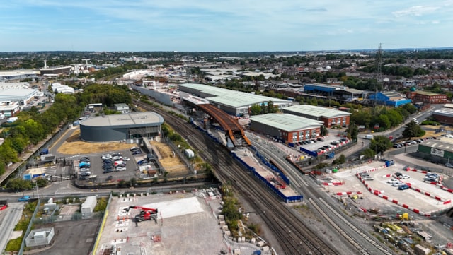

Nearer Birmingham, HS2 has issued a media release with video links of launch of Duddeston Junction viaduct
HS2 engineers have completed the first major phase of work to launch the Duddeston Junction Viaduct over the Birmingham to Derby railway lines.
It marks the start of a huge operation to cross six railway tracks – three freight lines and three passenger lines - which is expected to conclude next summer.
Duddeston Junction is the first, and longest, in a series of five interconnecting viaducts – known as the Curzon Approaches - which weave through Birmingham’s industrial heartlands on the approach to Curzon Street Station.
While Curzon 2 is visually striking, Duddeston Junction Viaduct stands out for its geometry and complexity. The structure follows a varying horizontal curve and has a three percent gradient, rising from the ground to sit 12 metres above the existing tracks. This makes construction, logistics and alignment significantly more challenging.
This month, the engineering team behind the build and launch operation reached their first major milestone, as they successfully launched the first 170 metres of the 700-metre-long structure over two key freight lines that transport goods into the city
The weathering steel viaduct is formed of 14 spans, each around 55 metres long and cumulatively weighing up to 6835-tonnes. To successfully cross all six railway lines, the team must assemble and launch seven spans.
Each completed span is added to the rear of the structure, which is then pulled forward, using a tried and tested slide technique. After safely clearing the railway lines, the seven remaining spans will be lifted and lowered into place by crane on the opposite side of the railway.
