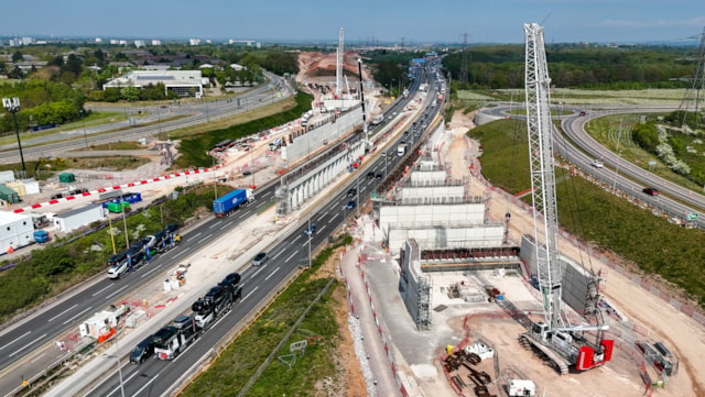

11,296
HS2 has announced the first slide of the northbound viaduct over M6 slip roads will be moved 11 April. This is on 4 track section.
The west deck of the M6 South viaduct, which will carry high speed trains towards Birmingham, is being assembled in four sections. The first 107 metre section will be slid over the M6 junction 4 southbound slip road on 11th April 2026.
The engineering team from Balfour Beatty VINCI, HS2’s contractor in the West Midlands, forecast that it will take just two days to safely manoeuvre the 1250-tonne weathering steel structure into place. Using the tried and tested slide technique, a giant hydraulic jack will pull the viaduct over the concrete piers, 102 metres away, where it will then be locked into position.
The slip road will close at 5am on Saturday, 11th April for the slide to begin. The viaduct is expected to be in position by Sunday evening and the 45-strong crew leading the operation will conduct final safety checks ahead of the slip road’s planned reopening at 10pm on 12th April.
The 320-metre-long West deck will be positioned parallel to the East deck, which was safely installed over the M6 in three stages in 2025. The final stage of the East deck installation was a UK-first in civil engineering, with the main carriageway remaining open and traffic flowing below as the viaduct was slid into place.

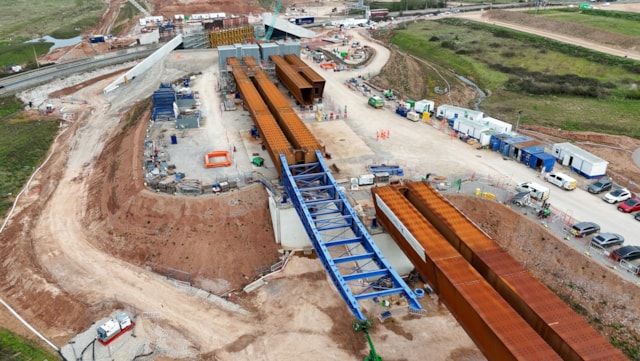

A new drone video has been posted, showing construction progress from south of M6, through Coleshill, along delta junction south to west spur to Bromford tunnel portal.
Can see the second M6 viaduct being extended before being pushed out, the dive under and flyover junctions and lots of earthworks
HS2 has issued media update with videos regarding upcoming installation of viaducts over the motorways
The M42 overhead works begin on the evening of Friday, 26th June 2026, with the installation of the roof deck for the twin box. This 300-metre-long structure will allow the high-speed line to be built over the M42. Once complete, vehicles will drive through the box, while trains travel above.
The walls for twin box are being built using a modular construction method, and these works are progressing at pace, without closing the motorway.
The roof deck will be constructed over four weekend closures, allowing engineers to install 175 individual beams, each weighing between 56 and 92-tonnes. The giant beams, which have been manufactured off-site in Leicestershire, will be lifted into place using a 300-tonne crawler crane.
At the same time, engineers in nearby Water Orton are preparing to extend two single-track viaducts that will carry high-speed trains into Birmingham Curzon Street and the rolling stock depot at Washwood Heath.
Already circa 1200 metres long, the team will use a different construction technique to build the remaining 135-metre sections of the Water Orton 1 and 2 viaducts that will bridge the gap between the piers either side of the motorway.
Instead of continuing with the cantilever construction method, the viaducts will be prefabricated in sections adjacent to the carriageway – removing the need for further closures. Once fully assembled, they will be moved into position using self-propelled modular transporters and locked into place above the piers. This significantly reduces the installation time and means engineers can complete the works in just four weekends. This programme of work will commence at 9pm on Friday, 24th July 2026.
The final construction challenge – the installation of the M6 South Viaduct West – requires just one weekend motorway closure, as two stages of the fully restrained slide process will take place over live traffic, eliminating the need to close the carriageway. The single weekend closure will commence at 9pm on Friday, 21st August 2026.
