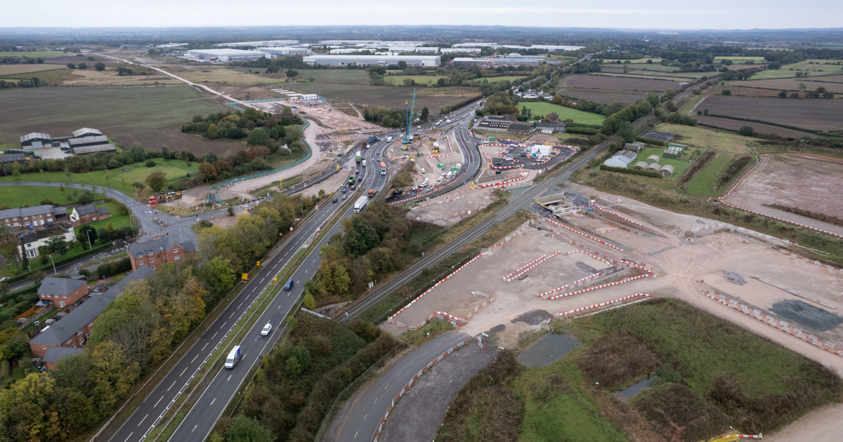

Balfour Beatty VINCI have issued an update, work has started piling for the A38 dual carriageway bridge, near Lichfield. A temporary deviation of the road has been built and once bridge is built road will be returned to normal alignment.
HS2 line runs in a cutting here on its way to Hansacre, and will pass under the A38, it's slip roads, and nearby under another rail line.
Balfour Beatty VINCI has begun foundation work for a new bridge that will take HS2 trains under a major A road on the outskirts of Lichfield, Staffordshire.
An expert team of engineers has started work directly underneath the A38 carriageway at Streethay to create the foundations of the Rykneld Street bridge, which are between 20 and 27 metres deep. The complex process involves sinking a total of 88 piles – a series of concrete pillars built underground to support the weight of the structure.
In preparation for the start of piling Balfour Beatty VINCI and National Highways have successfully built a temporary 320-metre stretch of the A38, which is now in operation. Once piling has been completed and the bridge deck is installed in late 2025, the realigned section of the road will be moved back to its original position where piling is now taking place – allowing space for the high-speed railway to pass underneath.
At 90.5 metres in length, HS2’s Rykneld Street bridge is the last of three retaining structures to be built at Streethay and contained within a 455-metre-long cutting through the ground. The trio of bridges, which also includes the A38 Southbound Slip Overbridge and the Streethay Overbridge, will enable the HS2 line to pass under the A38, its slip lanes and the existing South Staffordshire freight railway.
Around 750,000 cubic metres of earth will be excavated during the process of building the three bridges and reused to form embankments along the HS2 route locally.
Zachary Walker, Project Manager for Balfour Beatty VINCI, said: “We’re delivering a series of complex structures that will allow HS2 to pass underneath the A38, its slip lanes and the South Staffordshire freight railway near Lichfield.
“This exciting engineering project is about to move onto the next phase, as we begin the foundation work on the third and final bridge we’re building along this 455-metre retained cutting in Streethay.”
David Perry, Senior Project Manager for HS2 Ltd, said: “Carrying out a complex engineering operation of this scale in close proximity to a live carriageway comes with a unique set of challenges, requiring a multi-stage and collaborative approach from everyone involved.
“Our thanks go to National Highways, Balfour Beatty VINCI and our wider supply chain as we start this next phase of construction at Streethay and, importantly, to our dedicated site team charged with safely delivering the Rykneld Street structure.”
A series of phased traffic management measures will continue during the build process and road realignment phase, with HS2 and National Highways working together to keep traffic flowing and to minimise disruption for road users.
David Patmore, Network Planner for National Highways, said: “It is crucial for us that we keep traffic flowing and we do all we can to ensure people’s journeys on our roads are as smooth as possible. But complex operations such as this will inevitably cause some disruption. We have worked very hard and closely with HS2 and their partners to minimise that disruption.
“We will continue to do all we can to ease the impact of the works and would like to thank road users and local communities for their patience.”
The piling operation and ongoing engineering work is being carried out by Balfour Beatty VINCI together with SB3 – a joint venture made up of Bachy Soletanche and Balfour Beatty Ground Engineering.
The new bridge was designed by a design joint venture of Mott MacDonald and SYSTRA working for Balfour Beatty VINCI.

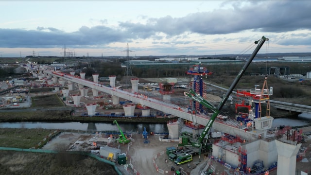

HS2 has announced the first of the delta junction viaducts has been completed. The single track 472m River Thame west viaduct. A double track viaduct alongside is under construction (3 track section)
The first huge viaduct has been completed at HS2’s Delta Junction in North Warwickshire, marking a major milestone as construction ramps up on the high-speed line in the region.
A team of 40 people working for HS2’s contractor in the Midlands, Balfour Beatty VINCI, used a giant cantilever structure to build the 472 metre single-track River Tame West Viaduct.
It is the first time in the UK that the technique has been deployed - moving the concrete segments into place span-by-span, making it an efficient and flexible construction process.
Work started on the viaduct’s piers in 2023, followed by the concrete deck construction starting in early 2024. Since then, 190 pre-cast concrete viaduct segments have been lifted into place using the specialist cantilever technique.
The River Tame West Viaducts will carry three rail tracks in total, made up of one single track viaduct and one double-track viaduct. Work is now underway on the double-track viaduct.
