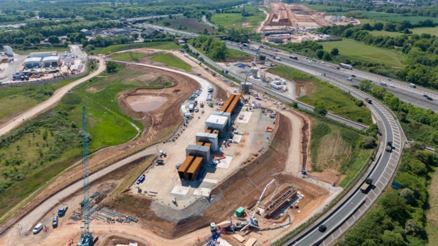

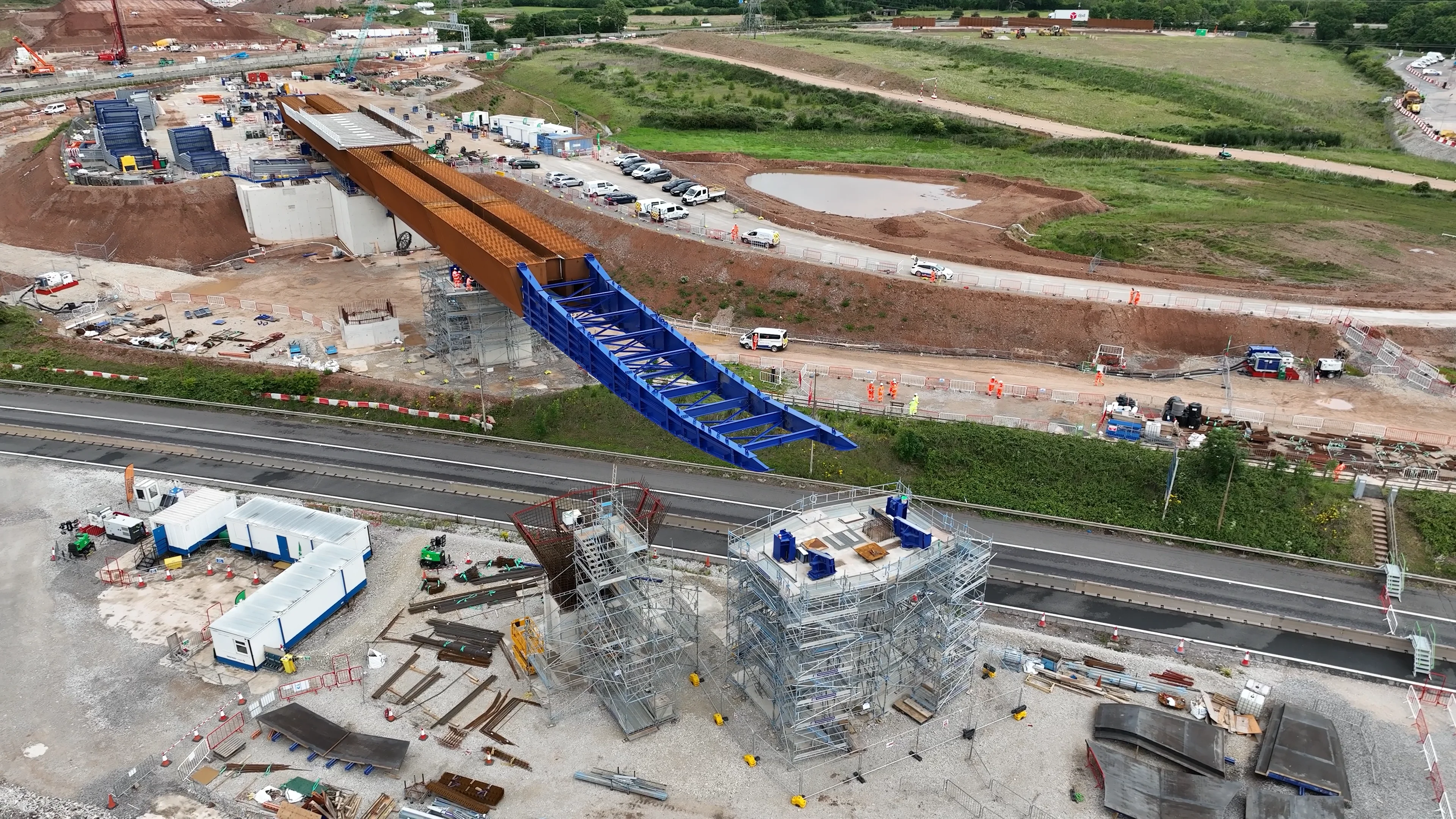

Nice close up shots of the beginnings of the M42 / M6 Toll bridge. The red/blue structure looks the same technique used for the first spans of the River Tame viaduct, reported by HS2 here in Dec 23. The two steel trusses create a frame for the segments to be dropped onto and supported by while the internal tensioning is installed.
No sign of any intermediate piers in the middle of the motorway or on the embankment yet.
I think, (going by the drawing in post #330), the two approach embankments will be extended much closer to the northbound carriageway and will be built around the concrete abutments that are partially completed.
