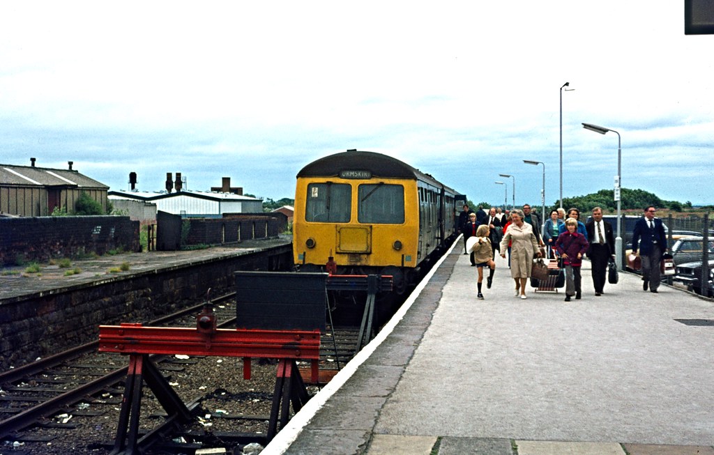

(Wouldn't it be more space-efficient (and, perhaps, safer in the case of a buffer-stop collision) to have one platform either side of an island platform, rather than the end-on arrangement? Anyway, that's a discussion for another thread so I'll leave it there.)
It's relevant to the thread because such a layout would have altered the effect of the over-run. Similarly if the two platforms had remained in use, one for Merseyrail and one for Northern with passengers crossing over the bridge rather than the walkway built under the bridge.
I guess it all comes down to what was considered satisfactory at the time the through route was severed.
My 1977 rail atlas has Kirkby as 'two black dots' with no link between, plus the 'red line' serving the freight terminal.
At Ormskirk, a similar situation, the 1977 rail atlas shows a crossing loop on a single line. The 1978 atlas has it as 'two black dots' with no link in between with the loop line retained for through running for freight. I remember that arrangement but cannot recall whether the passenger 'terminus' line was actually severed or whether two buffers stops were simply placed upon it. Again, with the loop having existed before (and after) severing, it would have been possible to reduce the risk of an end-on collision by use of the two platforms but causing inconvenience to passengers as a result.

I rember that arrangement but cannot recall whether the passenger 'terminus' line was actually severed or whether two buffers stops were simply placed upon it. Again, with the loop having existed before (and after) severing, it would have been possible to reduce the risk of an end-on collision by use of the two platforms but causing inconvenience to passengers as a result.
Yes track was severed two of my photos on Flickr show it.
