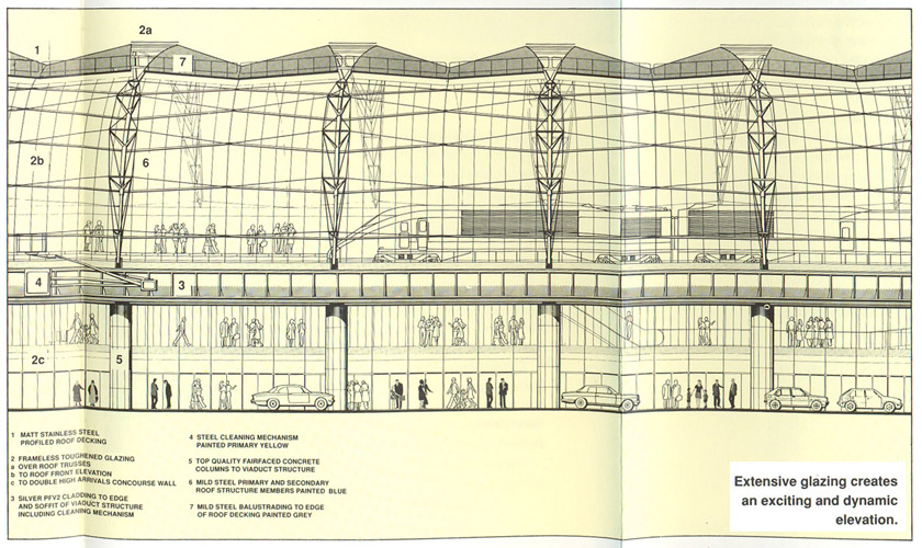

It doesn't seem like yesterday we were all stood round looking at images like this - I can hardly believe it's been built, used for Eurostar, made redundant and has sat mostly unused for 8 years now. Where, exactly, has the time gone ?

I had the opportunity on Saturday to inspect the platforms at Waterloo International... Jesus H Christ do they look awful! In my own humble opinion, Ardwick looks in a better state then they do
I'd agree. Its remarkable that the international station was ever really considered a good building architecturally, because as a normal station it is pretty poor.
I'd rather they'd matched and extended the existing roof sideways to be honest. Perhaps Grimshaw at Waterloo was told to be different with his new bit, like the way they were prevented from extending St Pancras with a matching design.
Will be interesting to see how Waterloo turns out with all the planned changes though.
