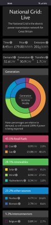

As for electricity generation, you can't cherry pick one bad day where coal powered stations had to be fired up. Look as a whole for the whole year, including what is generating power overnight when most EVs are being charged.
Good point. If anyone is interested in the data, then the I Am Kate website has live generating data as well as weekly, yearly, and all time.
I've attached a picture showing today's live figures showing oil and gas generation at 43.1% fossil fuels, 28.5% renewable, and 23.2% other sources (nuclear and biomass).
