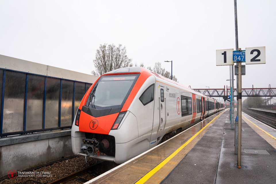

Is this to basically limit the amount of diesel they use ?
Partly, the official reasons seem to include reducing noise in urban areas, less emissions and greener, and operational benefits
TfW says the conversion programme will deliver both operational and environmental benefits. By making greater use of electric traction, the trains will reduce diesel consumption, lower carbon emissions and decrease noise levels, particularly in urban areas and around stations.

Unless this is incorrect reporting, the RAIL article states
Class 231s currently operate alongside ‘756s’ and Class 150s in South Wales but are due to move onto more main line and Vale of Glamorgan Line services once Class 398 tram-trains are rolled out on the South Wales Metro.
I thought that the VoG line will be getting 756s, hence why there has been late night testing of 756s on the VoG in recent months?
There's only 11 x 231s, keeping some on Rhymney - Bridgend (currently 4 diagrams at 1tph) won't leave many for the mainline

In case you are confused.
Class 755 already exists (in Anglia).
With the 231 gaining pantographs they will be very much like the existing 755s (these are Bi-Mode so diesel and 25KV AC). Not like the existing 756s (these are tri-mode so diesel, 25KV AC AND battery).
I doubt the actual class number for the 231s will get changed, if it does it may not be 755 but perhaps 757. BUT that is for conjecture on separate thread.

Transport for Wales has confirmed it is planning to convert its Class 231 diesel-electric units into bi-modes.
The fleet of 11 Stadler-built sets will have pantographs fitted over the coming years after TfW decided to activate a Hybrid Variation Agreement with the manufacturer.
TfW Chief Commercial Officer, Alexia Course, said: "We can confirm that work is being mobilised to convert our Class 231 fleet into hybrid trains, following approval and funding from the Welsh Government and agreement with our delivery partners.
"This programme will reduce reliance on diesel, cut emissions and noise, and give us greater flexibility to operate the fleet more efficiently across the network, supporting our longer-term decarbonisation ambitions.”
Course said work will be “delivered on a phased basis over several years”.
