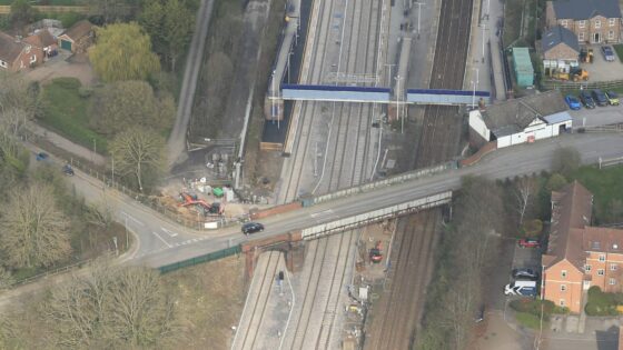

The old part of the A62 bridge is still there.
The new staircases and footbridge at Deighton have been installed.
