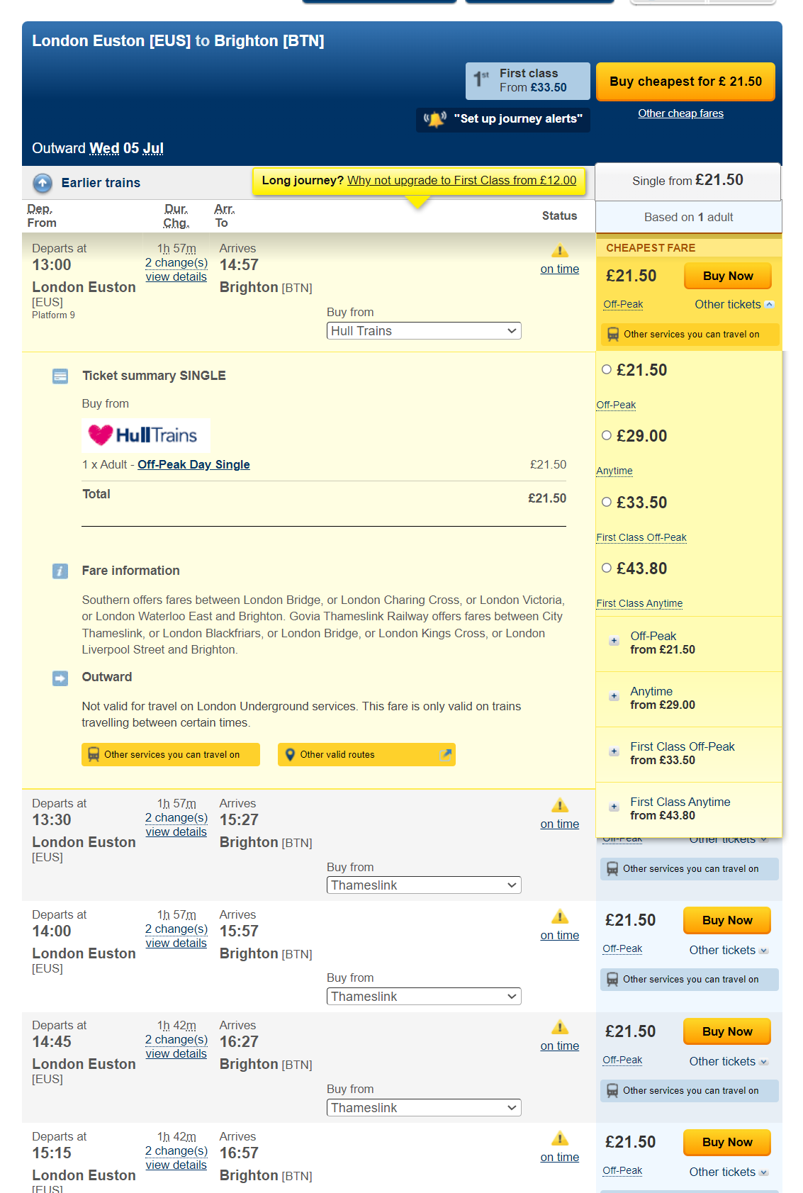

Hi, I am going to travel back to Brighton after traveling to the West Coast Main Line at London Euston. I was searching for tickets from London Euston to Brighton on trainsplit and found a ticket called "London Thameslink to Brighton" that is priced the same as the ticket from St Pancras to Brighton. It also allows me to take the London Overground without having to walk 10 minutes to nearby St Pancras International. Although I know it's a bit time-consuming, at least it gives me another option. However, I'm not sure if London Euston is part of London Thames. Can someone tell me the actual train station range covered by London Thameslink?Should I buy that ticket to travel with London overground?
Benjwri
16 Jan 2022
3,288
Bath
Is Trainsplit offering a London Thameslink to Brighton ticket with an itinerary from Euston?
This is definitely not valid as a ticket by itself. using the London Thameslink destination to Brighton is valid from:

Ah interesting. It shouldn't be doing that, and if you turn up at the station with the ticket alone you will almost certainly be denied travel. That being said, with the itinerary from TrainSplit, it is valid for travel on the specific train which you are taking. You are effectively limiting yourself to an Advance ticket, at least for the leg of your journey to St Pancras, where if questioned you will have to show the itinerary.
Even with the itinerary you might be declined entry to the train, in which case you would have to buy a ticket to St Pancras and claim it back from TrainSplit

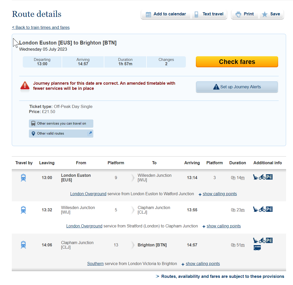

It doesn't seem to include St Pancras in the itinerary, though?
That screenshot is routing the OP on the Overground from Euston to Willesden Junction, then Overground to Clapham Junction and then from there to Brighton, which would be Southern not Thameslink?
I suspect, then, that the itinerary is displaying "London Thameslink" in error rather than the routing being in error?

The itinerary shown is the shortest distance wholly by rail from London Euston to Brighton, without passing any of the other stations in London Thameslink group.
I have read that, for the data purpose, Euston is a group member of London Thameslink, so it is valid in terms of how journey planners implement the route.
