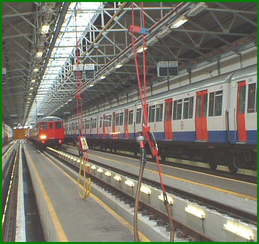

London Underground use the "shed lead" system.
An excellent article on it is here, with a photo from the page reproduced below:
http://www.districtdave.co.uk/html/current_supply.html
Thank-you causton, that's answered the main technical point. I suppose all the depots have these drop-leads now.

For locations where regular maintenance below the sole bar - or water-based cleaning - is required, there are indeed overhead flexible cable power systems. Where I work these are usually provided with a side-by-side emergency stop button system, also hanging from cables from the ceiling, as well as a power control panel in each shed which can be operated by a designated person (not to mention the local Electrical Control Operator being in overall charge of the whole lot). Sometimes there are "trolley cable" (names may vary) systems where the overhead cables are mounted on a runner, on which they may slide as the train moves. Other cables may just provide power to static units to allow the third rail to be turned off during maintenance or cleaning only. Both systems can be found running side-by-side with the third rail, or you can have situations where only one method of power is provided, but if both, only one would usually be utilised for movement at any one time.
Sometimes units may coast into sheds, but more regularly they will stop at a position-light signal protecting the shed. Not only will this allow the method of power to be clearly specified to the driver, if it could be either overhead-mounted cable or third rail, but it will also allow any warning system (warning of train movements) to be activated, in case any maintenance staff are on or near the lines in the shed, and for any cables to be connected up. Sometimes trains may travel into a shed on third rail power and then switch to a shed overhead cable system in situ. This can also be a convenient moment to switch between mainline and depot drivers, especially if the walking routes to or from the shed are circuitous.
When entering or leaving a shed on cable power, drivers would be expected to stop at a specific point where a proportion of the train would still be on the third rail - sometimes when part-way in or out of the shed - which would be briefed as part of route knowledge or, if it can vary, by the designated person in charge of movements.

At our place there is only the "shore supply" inside the shed, which as mentioned above is a cable system that plugs in to the inter-coach connectors. The third rail stops outside the shed, so we have to coast in all the way to the end. On leaving the shed, shore supply is used to be able to move the train out until the first shoe is on the rail, then shore supply is disconnected. Off we go! (With authority of course) ;)
