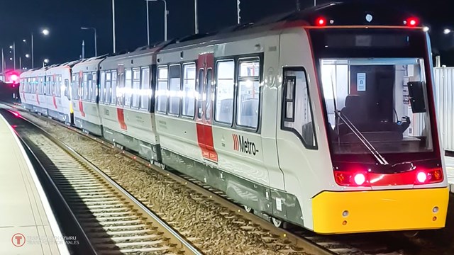

If Stadler are describing their own product accurately, opening the windows will render the cooling system ineffective.
The product was inherited by Stadler when they bought out Vossloh in 2015, it's not their design, only branding applied.
The trial runs have also been cancelled today again due to unit failures, the issue is rain water leaking in and soaking the electrics in the roof, which is where the brake control units are located
