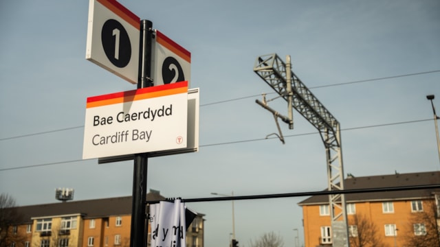

TfW were very clever with the wording of the press release of the completion of electrification of 100% of the CVL on Monday. The headline made it sound like the entire network is now fully electrified, but the notes to editors at the bottom states:
2026: Cardiff Bay section tested in preparation for 100% electrification of the CVL network.
So is Cardiff Bay still not yet live?
Without going into detail, the wires should be considered live at all times, even though trains aren’t using them, there are still tests being conducted. But, the line is simply not ready, and needs a lot of work to get it up to the required specifications. Compare the same length of track to projects in other countries, and it’s a complete and utter shambles. There’s no excuse why they couldn’t have finished the project.
But, as like other things, it is running on a limited budget, which also has to fund variable costs throughout. The reality of a devolved infrastructure system.
The Welsh government are expecting a massive miracle, the metro is years behind in reality where they are marketing it. They can post as much content as they like about 4ph and new trains, it’s not happening in their term.
800 million was not spent on the metro either, the majority of that cost went on the 197’s. The CVL was done on the cheapest option possible, and it’s hurting them more now because the 398’s aren’t compatible out of the box. Also buying the units and then going onto online forums for help from the community to get them into service. That’s what they have been doing. The team running the integration process just don’t have the knowledge.
With a bit of luck a new government will focus investment where it’s needed most, not on more vanity projects before they have even finished what they have started.
