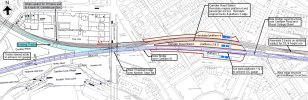

1) A new tunnel (doible track?) is built from OOC to somewhere near Primrose Hill
2) All Southeastern High Speed services (up to 8tph) reverse at St Pancras platforms 11-13 before heading west over new build track to that new tunnel, to terminate at OOC, and vice versa
3) 8tph HS2 services (of the 10-12 that will run when Phase 1 is complete) head via this new tunnel to St Pancras platforms 11-13 (max length 295 metres), either terminating there or continuing east to Stratford (2 tph each way), Ebbsfleet (2 tph each way) or Ashford (2tph each way).
Assuming I’m correct, and putting to one side for now the 10 year delay to the project this would entail, can you just check your working on platform usage at St Pancras with 24tph turning each hour, using the hesdways and junction margins at St Pancras and minimum turnback times and minimum platform reoccupations?
1) The proposed tunnel from OOC is cut short in railway land north of Juniper crescent ( currently occupied by HS2 temporary offices / portacabins ) ascending by the roundhouse to the NNL. Stub ramp(s) ascending in existing sidings west of Euston tracks to join a widened surface route to any future Euston platforms ( eg 2 or 3 for HS2 built if it reaches Manchester.
I’m not suggesting a 2nd tunnel. I’m saying cut the tunnel about to be built at a Primrose Hill junction where both HS2 tracks connect to the NNL and a 3rd track ascends to join a slightly wider existing Euston throat and a couple of possible future platforms at Euston.
The main line would head for St Pancras.
That Euston ramp could built later.
2) There are only 4 Javelins per hour. They would all reverse in around 4 minutes to extend west to OOC ( ideally Heathrow replacing Heathrow express if a single track ramp similar to the one at Stratford linked HS2 tracks to the GWR at OOC).
3) 8 initial 200m classic compatible HS2 trains reverse at St Pancras Javelin platforms using 24 7.5 min slots. Birmingham trains don’t need to be cleaned at both ends so could terminate in a double slot. Others could extend to Stratford or Ebbsfleet or Ashford.
Doing this would take LESS time than waiting for Euston to be built because it’s far simpler to replace 6 road bridge superstructures ( Whaley bridge took 6 weeks ). St Pancras would need a new single track overbridge and the existing NNL chord widened to two tracks.
New escalators & lifts to the Javelin platforms ( on the side wall) and maybe that drafty atrium filled in to provide more 1st floor space. All at HS1 expense as they’d benefit. All possible by 2030.
Turnback times work now as Javelins actually can terminate and turn around in 10 minutes. It only takes a driver 2 minutes to walk to the end of a 200m train so reversals within 4 or 5 minutes within 24 7.5 minute slots works. 30 6 minute slots adds resilience.
I would suggest setting up the javelin side of platform 10 as a possible emergency platform for rush hours or resilience reasons. It’s got platforms either side and Eurostar doesn’t need it all day long.
The key points are that as these platforms already exist this is FASTER to open than getting Euston built. The TBMs at OOC dig east to Primrose Hill instead of Euston. Faster.
We boost HS2 passengers by connecting to Thameslink, Javelins , Kent and Stratford. We boost revenue by £1 billion a year, get it open to central London years SOONER and save £6 billion at Euston by reducing what’s needed there and postponing it until HS2 reaches Manchester.
HS2 phase 1 will only have about 8 trains / hr.
When it gets more then we can send some of those to the Eurostar platforms if some of them also run to OOC instead of St Pancras.
Why do only 2 Eurostars / hr occupy 6 platforms? They don’t in Paris. HS1 staff admit they under use those platforms. 1st floor space at St Pancras is also under used. And there is room to add a balcony over the Javelin platforms. Room for expansion.

Totally agree. But simplest link is to terminate the tunnel from Old Oak at Primrose Hill with two ramps ( ie both tracks ) linking to the North London line route to St Pancras. Restore 4 tracking and both old platforms at Camden Town to take TfL and freight. Reversing Javelins at St Pancras to terminate them at OOC creates 24 slots of 7.5m each on the Javelin platforms to take 8 Classic compatible HS2 trains to St Pancras instead of Euston with them terminating at those 6 unused platforms at Stratford (2) , Ebbsfleet (2) or Ashford (2). That would create 12 tph across London from OOC to St Pancras and Stratford. It boosts HS2 demand 47% for 70% of London and the South East as well as GWR demand by connecting the Thameslink, Javelin , Kings Cross , MML and Great Eastern networks to HS2 and the GWR ( plus Heathrow).
Forget that Euston dead end. Just use St Pancras and unused HS1 platforms to terminate all HS2 trains until HS2 reaches Manchester again - by which time we’d only need 3 or 4 platforms at Euston and the whole of Euston could be rebuilt as a single level integrated station with just a single track from HS2 for just 4 trains / hr.
St Pancras and existing unused HS1 platforms at Stratford, Ebbsfleet and Ashford could handle 11 HS2 trains per hour.
Can you draw this?
Won't you end up with a massive bottleneck where there is only 2 tracks going over Kentish Town Road?
Unless that is the 4 tracking is extended eastward which would require buildings to be knocked down.
Popping the tunnel out at Primrose Hill looks no trival given the amount of multi-level tracks in that area.
Can you draw this?
Here are some drawings. No bottleneck as there'd be 4 tracking (just restoring the original 4 tracks onto existing railway land (see last of the images below).
TfL and freight would use the restored tracks (with freight continuing in 8 slots between Overground trains to run from Stratford to Willesden - as they do now to Camden).
Right now only one freight each way an hour uses the route to Primrose Hill. Just take those to Willesden and the Camden Town station to Primrose Hill route is totally free for HS2 trains and Javelins - which could be signalled to cope with 24 tph at 40mph (which is a good enough speed for trains slowing down to reach St Pancras platforms).
These drawings adapt the original Arup drawings that proved this route works. But by using it for TWO tracks and at least 12 tph instead of just a couple of Eurostars it's viable.
Popping the tunnel out on railway land just north of Juniper Crescent (where HS2 now have their temporary offices) is easy with the ramp curving around onto the NNL and reaching ground level before the road bridge - as HS2 gradients. I've checked on Autocad and measured the viaduct width to check that a pair of GC guage trains fit.
Only the top floor of a dentists practice would be demolished (at Kentish Town Rd where the viaduct needs widening for 4 tracks). Only one building 1st floor. That building could be rebuilt into the back garden - to restore the same space as a single floor structure under the new viaduct.
I'm a retired Architect who worked on the Channel Tunnel UK terminal. I've also put these ideas to HS1 Ltd directors, Ministers and Campaign for better Transport.

Right, down to brass tacks.
1) Can you explain why you think St Pancras has only 6tph from 9 platforms. Between 0800-0900 tomorrow there are 18 train movements in or out of St Pancras P5-P13. At the peak times there are 7 Southeastern High Speed services each way, and that is likely to be 8 before too long. Are you proposing that all of these continue onto HS2?
2) The existing track layout at St Pancras is not conducive to frequent reversals from Stratford and towards Camden. It can only be done in the international platforms, not the domestic. To enable the domestic platforms to be used as such would require wholesale remodelling of the throat, and almost certainly reduced speeds. The reduced speed would extend junction clearance margins and the platform reoccupation would need to increase from the current 4 minutes, probably to 6.
3) The international platforms at St P are international gauge (and height), the domestic platforms are domestic gauge (and height), and also only 295m. Which are to be used in your proposal by the Southeastern High Speed services (240m), and the HS2 services (400m), all of which will be formed of domestic gauge stock?
4) Put simply, it would not be possible to turn round the quantity of services at St Pancras you propose to, using any of the platforms, simply because of the large number of conflicting movements - up to 40 an hour at peaktimes - it would cause on any track layout at grade.
5) Turning 400m HS2 trains in 3.5 minutes might be possible, but only if there are not large numbers of people alighting and boarding, which there would be. Nowhere in the world does this.
5) The existing (unused) link between St Pancras and the North London Line is single track. As was the (non-existing) proposed link from there to Old Oak Common. Your proposal implies this would all be double track. Clearly this costs money, as there would be several new structures to build. As the above linked report also explains, it also requires lots of demolition in central Camden, including of listed buildings. It also means closing the NLL for some time to enable the rebuild, and I suspect would permanently reduce the capacity of the NLL too (unless much further demolition was preferred). This would take 7-8 years minimum from where we are now, plus several billion pounds.
6) There is no link from the HS2 OOC box towards Heathrow. Therefore having Southeastern High Speed services go to Heathrow is a non starter. (Unless you want to rebuild the OOC box and / or build new subterrean junctions west of OOC, and grade seperated junctions on to the GWML; as with the Camden end this would take about 7-8 years minimum from where we are now plus several billion pounds).
7) To use the international platforms at Stratford for trains terminating from the west requires either a shunt move on the running line east of Ripple Lane, or wrong line running between St Pancras and Stratford. Neither are easily timetabled.
8) Your assumptions about traffic generation from the direct link are baffling to me and seem to be very optimistic. I have never seen any modelled data to suggest that through trains from Kent to OOC would drive anything like the increases you suggest, similarly for through trains from HS2 towards Kent. How have you calculated them? Could you give some examples of journeys that are made much easier, and what the current flows are?
9) Kings Cross St Pancras tube does not have lots of spare capacity, as anyone using it on a weekday morning will attest.
10) Alternatives to Euston were studied extensively during the early stage of development for HS2. Using St Pancras was considered, but not taken forward. Am I right to assume that you feel the teams of professional engineers, rail operations experts, station capacity experts, town planners, construction planners, environmental managers and analysts who did this work reached the wrong conclusion, but your proposal is the right one?
In summary, doing what you propose would actually be likely to cost more than going to Euston, and take somewhat longer (as we’d be starting from scratch for planning and consents), if it was even possible, which appears not to be the case for much of it.

Thanks. Sorry for the caps by the way. Silly habit of mine.
1) You've doubled tph for movements. There normally are 6 tph (12 movements). I've allowed for 8 slots for Javelins and 16 for HS2 trains - which are indeed being built to cope with either height of platform. Yes, all 4 (or 5) Javelins would continue to OOC.
2) I too would prefer using the Eurostar platforms, and HS1 agree they are "underused" right now. They want to pause discussion of that until they've worked out deals with Virgin, but even with a doubling of Eurostar style services, those platforms would remain underused and resilience stock could be parked in the ECML and MML chords.
I agree that an overbridge is needed (and I've drawn one curving across Eurostar tracks to the Javelin approach). The chord to the NNL needs 2 tracks. But the tracks towards Eurostar platforms could be crossed for most of each hour as there really are only 4 train movements (perhaps 8 in the future) each hour to and from those 6 platforms.
As you say, the St Pancras throat is already well designed and capable of taking extra train movements with these changes (all far cheaper than building a 10 platform Euston).
3) As just said, HS2 trains are now designed to cope with either platform height.
4) I would agree that using a couple of the Eurostar platforms is better. But why don't we explore this more - as the cost savings and market boosting makes it worthwhile. I'm an Architect rather than rail person, so I agree that a solution needs to be found here. Let's work on that though rather than giving up.
5) They would all be 2 track as explained. 4 tracking the NNL actually leaves room for a 3 track approach you will see.
You say "nowhere else reverses trains this fast", but Frankfurt HbH reverses ICE trains in 4 to 5 minutes. All day long with ICE (high speed trains).
Tokyo even cleans trains and terminates them in only 10-12 minutes. (Evidence in the photos I took there below - where the indicator shows 15 minute slots).
6) Initially HS2 will only be running 200m classic compatible trains. Hence Options 1 and 2 only deal with up to 8 of those trains/hr. Longer term, 400m trains would need to use a couple of those 6 Eurostar platforms or be sent to a by then built Euston. But most HS2 trains will remain as those 200m long "classic compatibles". And we could explore that idea of shared Eurostar style trains bidding for the franchises for Manchester trains with 1/3rd international and 2/3rds domestic swopping on platforms 5 & 10.
7) A minor track adjustment to the route up to the Temple Mills ramp would enable terminating trains to reach either of the central platforms there.
Through trains would be switched to the disused outer platforms as that wouldn't cause the fast lines to be crossed. Again these are 200m classic compatible HS2 trains.
8) I'm not talking about Kent trains being the main traffic boost. Its the connections to the vast Thameslink network (plus easier links via London Bridge than to Euston) that causes the main boost. 70% of London benefits there. Javelins, Piccadilly line, Stratford's link to Great Eastern, Kings X links from Cambridge, MML etc all add bits too. Kent is a smaller part. The PDFH says that for Thameslink passengers, using St Pancras instead of Euston cuts out a 65 minute interchange penalty and boosts markets by 47%.
That also works for Kings X traffic (eg from Cambridge) and to a lesser extent GE connections and Kent connections too.
9) Again, Thameslink has far more capacity than tube links from Euston. Kings X tube has vast capacity and more tube lines.

I cannot claim any technical knowledge, but it seems to me that it would be worth linking HS1 and HS2, not for international services north of London- I quite agree that they are not feasible- but to better integrate points east and southeast of London into the network.
Could there not be a service running, at the very least, Dover-Ashford-Ebbsfleet-Stratford-[St. Pancras or Euston]-Old Oak- Heathrow, or further afield,
Totally agree. And replacing steelwork over 6 road bridges, restoring 4 tracking onto existing railway land and restoring the 2 old Camden Town platforms is a lot cheaper than building Euston.
HS1 Ltd would need to add an extra overbridge to access Javelin platforms and add a couple more lifts onto the outside of the newer bit of St Pancras. But little else.
The top floor of St Pancras has loads of spare space. HS1 has 6 totally unused platforms to terminate trains. And high speed trains reverse at Frankfurt in only 5 minutes.
