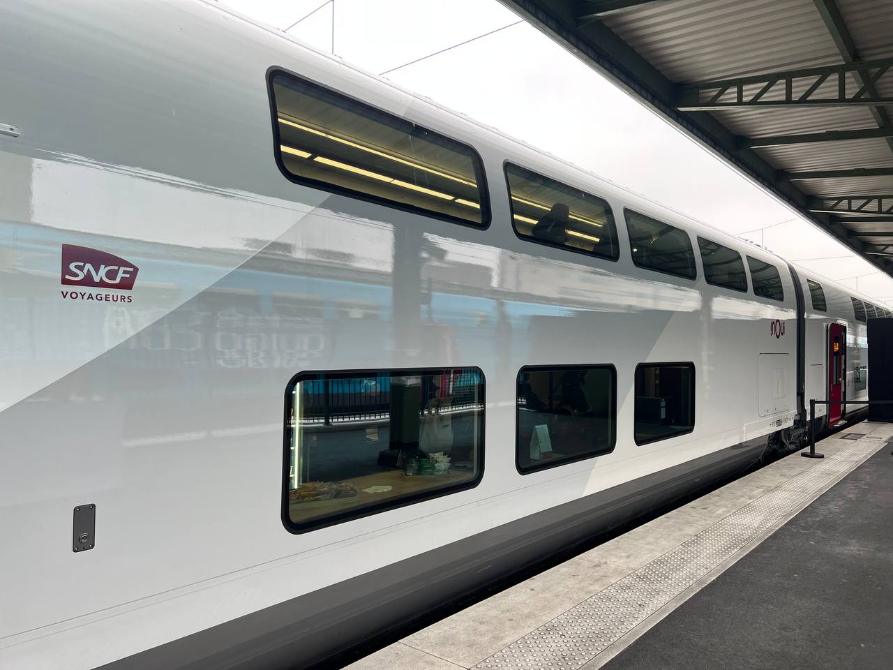

They made some weird system to move the floor level? I don't remember and I definitely lack the technical knowledge to comment much more in depth. But yeah it's likely it'll be TGV-M. That raises the interesting point of where the remaining e320 would be. Also, as they're 200 m sets, replacing all the e300, PBA and PBKA's, it's actually a net increase of... two 200 m trainsets, not much. Even though they should allow more service, as they intend to reduce turning time at termini and they've cut all service south of Paris/MLV.
11,293
Is it a problem with TGV-M not meeting the accessibility requirements, or separate problems with accessibility, and the TGV-M?
The problem is explained in detail in this article that I have just found.
Platforms normally 550mm or 760mm, but there is a door threshold at 617mm and a floor height of 300mm. It also seems the wheelchair lift equipped vehicles have active suspension and can be raised a bit when stationary to reduce platform-train height differences

This might be somewhat controversial, but if the TGV M poses such issues for accessibility on services that encounter both 550mm and 760mm platforms, then maybe a different train design makes more sense, whether it be from Siemens, Alstom, or even some other manufacturer.

Surely a single deck flat floor unit with distributed traction is the most straightforward choice?
Trainbike46
18 Sep 2021
4,383
belfast
So, something like the eurostar e320? That would make lots of sense. Maybe too much for Eurostar!
For non-high-speed trains there are also trains that have a mix of double and single deck coaches, would such a design make sense for a high-speed operation? Simply have the accessible seats and wheelchair places in the single deck sections.
They (eg the Omneo Premium) are ingenious, I agree - I wonder how you would cope with the aerodynamics at 330km/h though?
There's still the issue of two different platform heights to cope with.
That should be doable - the region 2N / Omneo premium already gets close by using the roof of the single-deck cars to install equipment. Or just have VERY tall ceilings on the single deck cars
The two main ways for dealing with the platform heights are:
- offer level boarding at 760mm (and a 21 cm step up 550mm, using a ramp at 550mm stations)
- have separate entry doors on the accessible coach, one for use at 550 mm stations, one for use at 760 mm stations, and use an internal fixed ramp to get to/from each door to the wheelchair spaces (I believe DB uses this approach on some rolling stock?)
