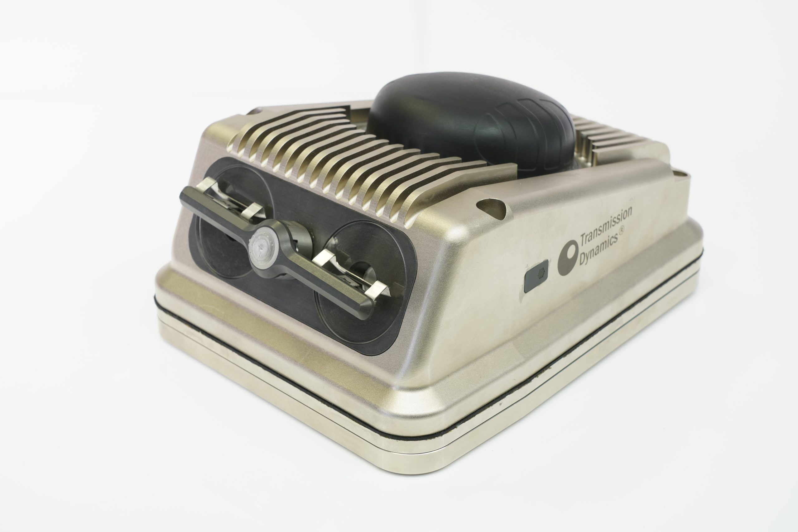

The pantograph video is from the PANDAS OLE monitoring system fitted to the Class 350 involved in the incident. The video appeared on the Transmission Dynamics account on LinkedIn within 40 minutes of the incident occurring.
Transmission Dynamics are the manufacturer of PANDAS and host and analyse the data downloaded from the trains in real time.
The PANDAS equipment comprises a pantograph mounted accelerometer and high quality video camera, with GPS tracking and automatic data download to ground. I was involved with initial trials and subsequent partial fleet fitment of this equipment on Class 390 trains. A significant number of Class 350s are also fitted with PANDAS, and it is gradually being introduced on other UK rolling stock.
When PANDAS detects an excessive acceleration event an alert is automatically triggered directly to the local OLE maintenance team. The LinkedIn post mentioned that the particular location where the dewirement occurred had previously been identified as requiring high priority intervention, but unfortunately the failure occurred before maintenance could be arranged.
Although PANDAS has been operational for several years now, the interpretation of the data is a constantly evolving process. No doubt this particular incident will be closely analysed to provide learning for future processes and procedures. I know from personal experience that the PANDAS system has been invaluable in detecting OLE defects that would have almost certainly ultimately resulted in a dewirement. As with all such monitoring systems there are limitations. It is difficult to identify defects on the components that are not directly connected to the contact wire, although video analysis is now being used to identify issues such as detached droppers.
I have no direct relationship with Transmission Dynamics, but I have been very impressed with the manner it has been developed and integrated into Network Rail's maintenance regime. However, I suspect there may be some questions asked regarding the publishing of potentially sensitive dewirement videos onto social media!
Impact Event Detection
Our real-time overhead line and catenary monitoring system identifies and mitigates a range of impacts, enabling targeted intervention that reduces faults, improves safety, and enhances service reliability.
AI and Machine Learning
We use advanced AI and machine learning models to continuously analyse pantograph and overhead line interactions, enabling the early detection of a wide range of issues. This allows timely intervention to prevent potential hazards and maintain uninterrupted rail operations.
