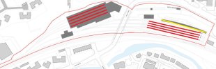

Looking at the planning application it looks like 8 EMUs will fit at Shipley depot at any given time, given that there usually seem to be something between 6-10 East EMUs not in traffic each day, and most of those are presumably at Neville Hill with a couple at Skipton, then surely the stabling at Bradford and Ilkley will need to continue as currently?
More than 8 will be able to be stabled there. Bear in mind the 331’s will be 3 car units (for instance 2 x 331’s will fit on a shed road).
The BDQ units will almost certainly stable on the depot whilst the Ilkley units could, although if they remain stabled at Ilkley for operational reasons that would also make sense.
Less units will be sat around through the day when the Bradford - Ilkley/Skipton services go back up to 2tph.
Hmm.
Planning application said:
a maintenance hall, bulk storage area, two-storey office and welfare block, this approximately 148.5 m x 41.9 m building will comprise a steel-framed portal building and will extend 14.55 m (to top of parapet) above the four sets of track contained within it (each track being able to accommodate a four-car EMU)
(Bradford City Council planning application 23/03622/SCR)
Which is reflected in measurements shown on the drawings suggesting a track length of 106m within the shed, which makes for 4x 26m, and certainly not 6x 23m.
Plus the stabling sidings across both sides of the site. A depot is more than just the shed building.

I was replying to your statement that "for instance 2 x 331’s will fit on a shed road" - the planning application clearly states otherwise.
The four stabling roads at the Shipley end of the site appear to be very similar length, theres an underframe wash road and thats it, so even at maximum capacity I can't see how more than 9x 3 or 4 car units can possibly fit on the site.
Sorry I misread that one as I was thinking of the stabling road lengths at the time.
I’ve just been looking at the plans on our system and the plan is for 12 units to stable overnight at Shipley TCC (6x3 car, 6x4 car). There is room for more if required but it’s unnecessary the vast majority of the time as Skipton BRCS will contain the bulk of the fleet overnight. 2 will stay at Ilkley, 2 at Leeds but none will go to Neville Hill at all in the current plan.
Units are planned on Shipley TCC through the day for maintenance swaps.
Hope this helps clear a few questions up.

I mean that clarifies what you meant, but I still don't see how 12 units can be stabled on this site.
Attached has 8 red lines for shed/stabling, 1 yellow for the underframe clean which gives you really a surge capacity of 9...
Also, seems a bit odd that none go to Neville Hill at all, given Shipley isn't going to have a wheel lathe.
Can each siding and the shed only hold one unit each or can they hold two each?
Hmm.
One unit only.
Well that’s the official unit plan for when it opens. I trust the person implicitly who has done the detailed work on this (since the start of the planning for this around 3 years ago).
