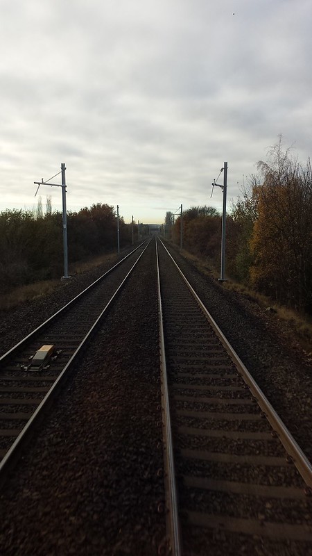

Any more news on the planned Parkside Junction to Castlefield Junction energisation that is planned any time now?
Following on from what I saw yesterday morning at St Helens Junction, here are some pictures that I took.
Phase 2 work is now in my neck of the woods! :D

Just a quick report to say that things again seem to have sped on around Garswood and St Helens Central. Central's Liverpool bound platform looks much like the Junction's does in DJH1971's pictures above, but there now seems to be pretty continuous mast or gantry upright work both ways from Garswood. Not sure how much further than Spindle Hillock or the M6 they've got (if even there!) in a Wigan direction, but things have certainly flown up this weekend.
Additionally, towards St Helens, there now seems to be an increase in gantry uprights around the college and timberyard by the Gerard's Bridge spur.
(sorry for the lack of appropriate terminology, but hopefully it's clear enough!)
