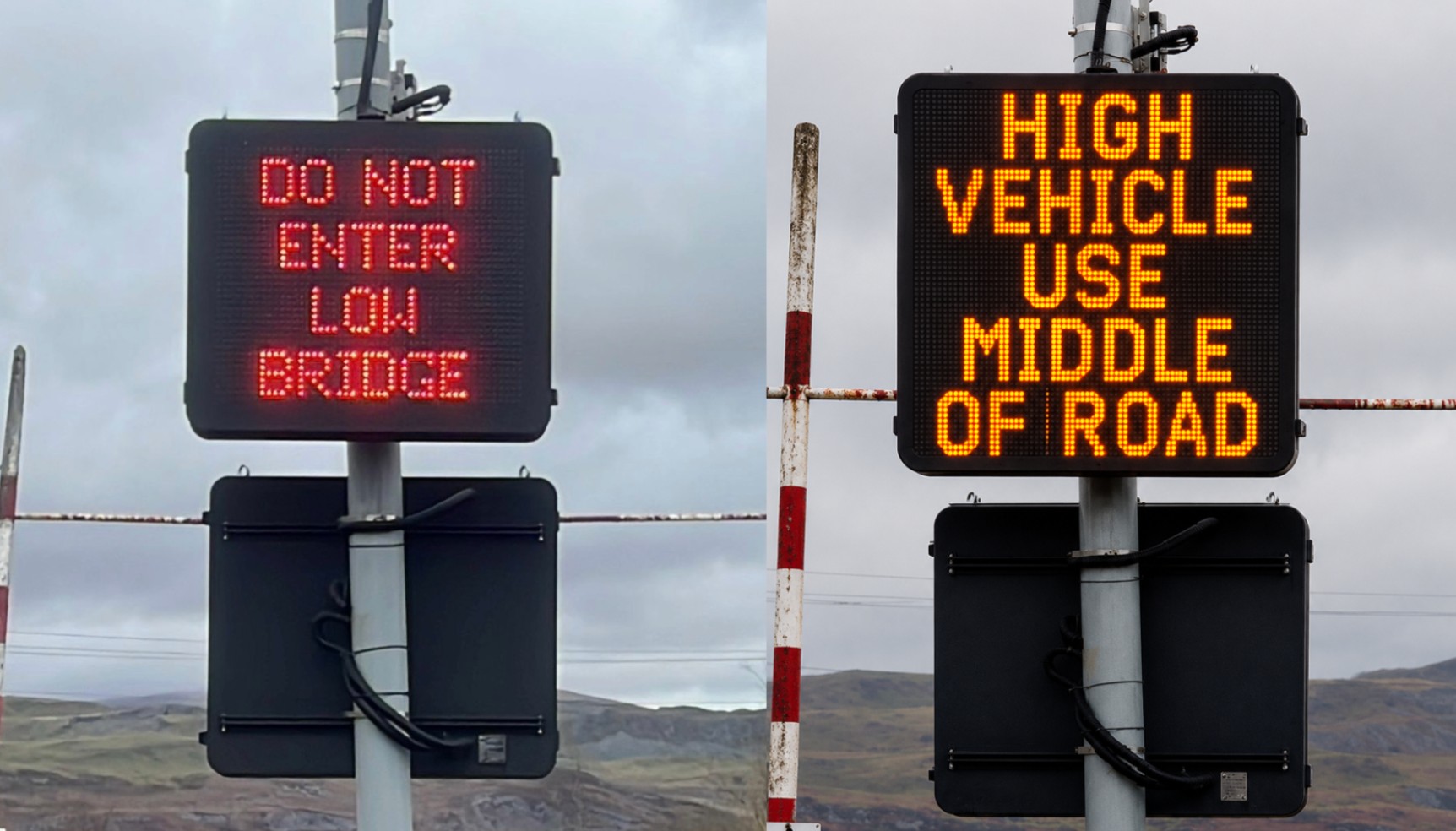

Not directly related, and not wanting to start a debate about innovation funding, but evidence that a gadget designed to provide the kind of early warning called for here does exist:
The roadside safety system is designed to reduce the number of over-height vehicles striking low railway bridges and has been developed through the UK Government Department for Transport’s ‘First-Of-A-Kind’ programme.
I wonder how far ahead of a bridge it can be installed? There is one near me but from one direction the nearest suitable alternative route is nearly a mile away.
And they are not new. Here's a surviving BBC news item from twenty years ago!

Since you don't need anything that complicated to make one, the surprise is that so few have ever been put in. Maybe they just are not very effective, and hard to make reliable enough. Those two in Swindon do seem to be still there, though Google Street View can hardly tell you if it's still operating.
There is a bit more detail about that GCRE one here. They seem to value getting the height to 6 mm, though I doubt that matters so much in practice. Nothing about enforcement, which you might suppose to be quite muscular for a "bouncer". That piece also says that this project got Government funding through the FOAK process, though that isn't proof of practical value.
Bridge strikes was one of the themes of the 2025 FOAK competition. The winning projects were these - several are for detector/warning sign systems; maybe somewhere in the various documents it explains why this needs reinventing!
