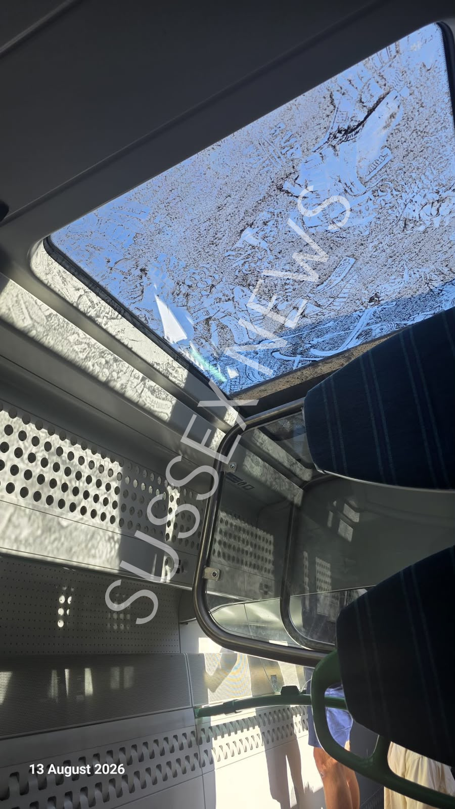

The BBC have verified this image showing the buckled track.

Could the buckle be exacerbated by the train derailment though, this appears too extreme to have happened since the previous service .
Thats my thought. If the front of the train went over that it would definately have been derailed aswell. I would say the embankment gave way under the train
