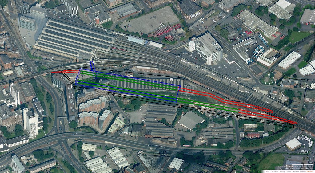

I came up with a rather radical concept this afternoon.
One thing you could do taking the existing WCML design methodology, is for the line to run to Manchester Airport then split, one line would run to the centre of Manchester then back out north to rejoin the existing WCML just after Preston, this would be underground at key points but aboveground where possible, it would be windy and slow 'classic'. A second 'faster' line would instead more closely follow the WCML/M6 with a station just north of Wigan (near M6 junction and likely called 'South Lancashire Parkway') serving Bolton and Preston as well it would then rejoin the WCML north of Preston at a similar location to that of the Manchester loop. This would mean the 'Classic compatible' Scotland services first WCML stop at Lancaster/Oxenholme/Carlisle. This offers the opportunity of faster services bypassing Manchester and a extra lucrative parkway (according to GMPTE Wigan NW has the highest number of Scotland passengers of any station in Greater Manchester, most Manchester users head south apparantly).
An alternative would be for a split earlier around Warrington, the airport would be on the Manchester loop and the mainline running closer to Merseyside would allow a full spur to the outskirts with classic trains into the centre. In a way the first allignment and stations layout kinda mirrors that around London/Heathrow.
