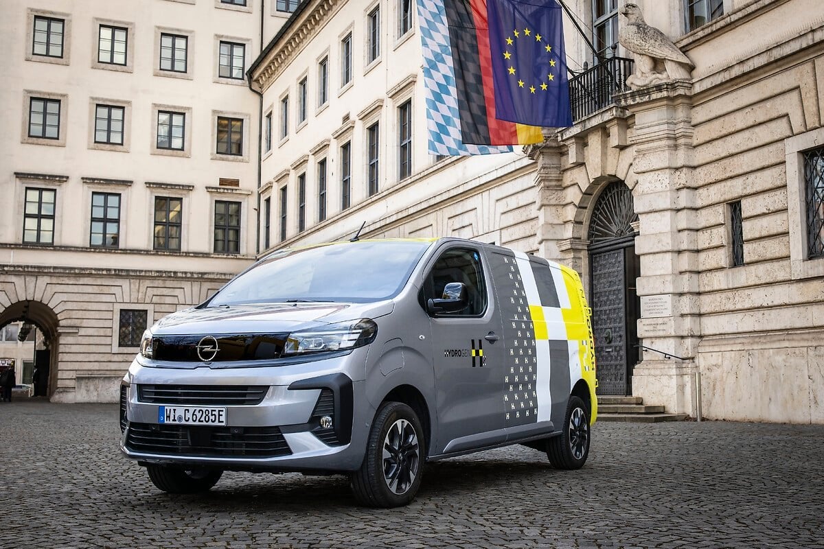

Hydrogen will never be a mass market fuel for public consumption, but it's perfectly affordable and safe for mass transit use, where refuelling is done in a professional environment where the costs of the stations are spread over a large fleet. London has had a small number of hydrogen buses operating for years.
Which isn't to say that it's a better option than battery, but to point out that it's not a completely concept.
The 20 hydrogen buses in London and 15 in Aberdeen have been working well low key for the past 4 years.
But the larger scale hydrogen trains in Germany have been problematic.
Interesting the hydrogen Vivaro van has been reduced in price, but still more expensive than the equivalent battery version.
So although hydrogen power is still to be used, new battery technology wins on reliability and cost.
