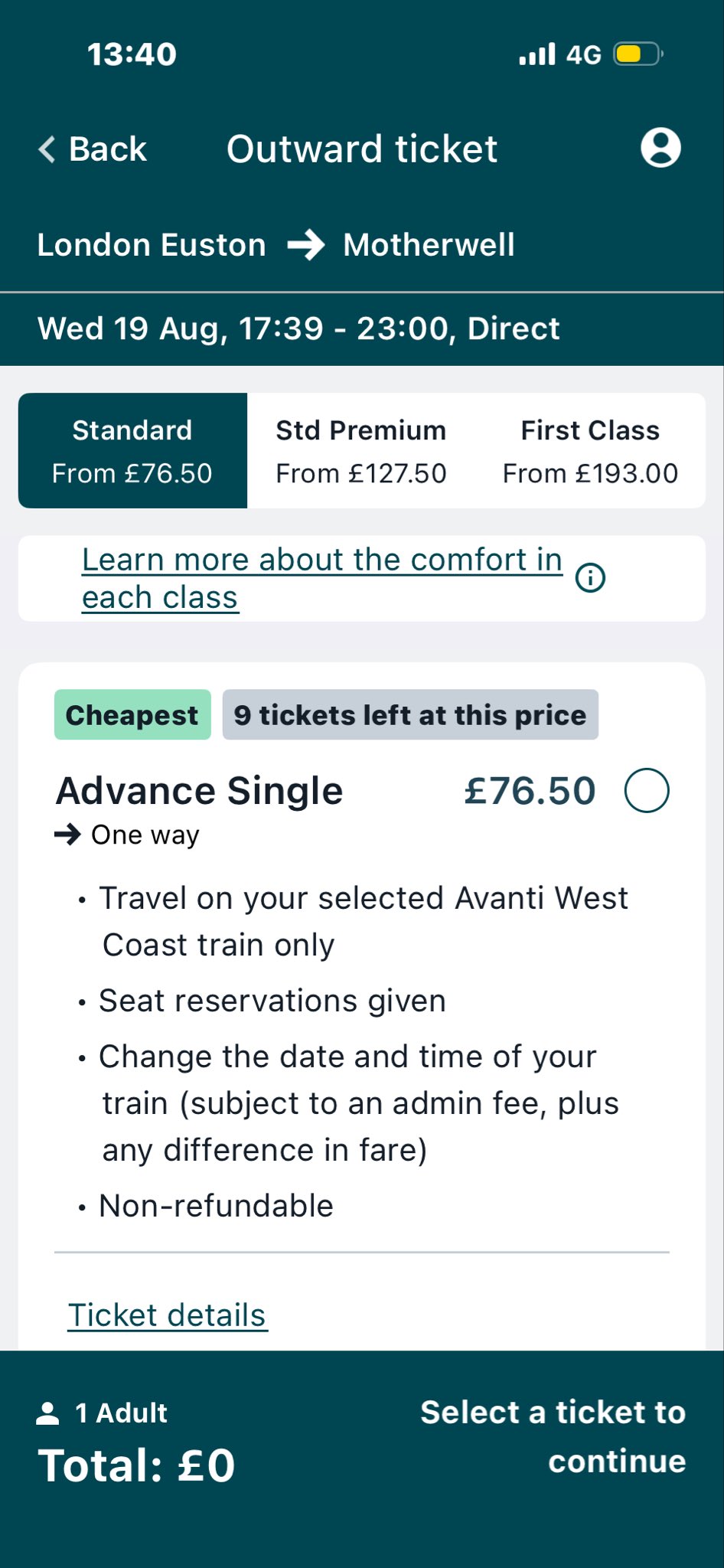

I've found the post; https://x.com/i/trending/2089404999730409570
Avanti West Coast explained the gap stems from peak-time rules applying to the Preston leg, but off-peak for the full Motherwell journey, with Advance tickets locked to the specific service and no breaks allowed. Passengers online joked about getting off early at Preston, where barriers are often absent, though others warned it risks penalty fares and ticket invalidation. The incident highlights ongoing frustrations with UK rail's complex pricing across operators and routes, where longer trips sometimes beat shorter ones in cost.
Why are
@AvantiWestCoast
ripping people off like this? If I want to get a ticket from London to Preston, they’re charging £190.00. But if I book the same departing train all the way to Motherwell (much further) it’s £76. I can then just get off at Preston anyway a save £120?!
Picture of suggested fares showing the both.Opera Snapshot_2026-08-17_193511_x.com.png

It isn't legit.
If caught that person would be liable to an excess fare up to the value of the cheapest appropriate ticket which does allow break of journey.

Even if you present a different ticket at any Preston blockade (it doesn't have barriers) you are still finishing your journey short on an Advance ticket. That isn't permitted and means you are liable to pay an excess (the difference between the cost of that Advance and the cheapest walk-up ticket permitting break of journey).
Whilst failing to pay that excess isn't automatically an offence, I can certainly see how breaking your journey when not permitted and then buying another 'throwaway' ticket to try and cover it up could be alleged to amount to intent to avoid payment. Which would render it an offence under section 5(3)(a) of the Regulation of Railways Act 1889.
Accredited journey planners can't offer overdistance tickets, as far as I'm aware,and certainly couldn't encourage a breach of the ticket terms and conditions.

Starting/finishing short with an Advance ticket is not strictly in accordance with the rules for Advance tickets, the policy of the Rail industry is that no additional fare should be charged (unless there is clear evidence of intent to try and avoid a higher fare).
The problem here is that there is clear intent to avoid a higher fare and therefore an excess fare could be charged.
