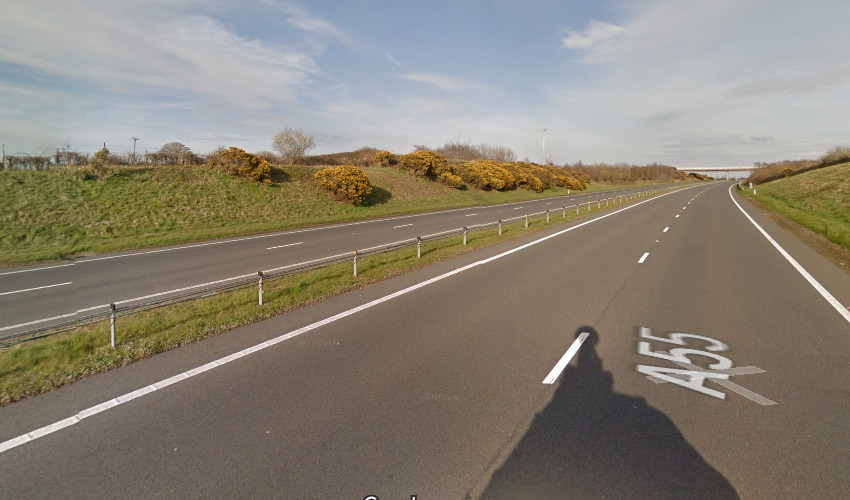

The further west you go , the less is the (passenger) traffic , freight is effectively dead.
That did not stop them building the motorway standard A55 (N.Wales Expressway) across Anglesey not so long ago, even though it is almost empty of traffic most of the time. I assume it was an EU sop to Ireland.

I love the idea that the A55 is unused and empty.
LOL The Irony
29 Jul 2017
5,335
Chinatown, New York
The OP must have A) looked and looked until they found an empty streach, then used that, B) clicked street view in a random area and took it as gospel or C) the street view car came through on a quiet day/it was a quiet stretch because that's how traffic flow works.
Not sure if this is trolling or real - but if you were to dump the contents of two full ferries arriving simultaneously every 6 hours on to the old single carriageway A5, then I suppose you might find a desire to electrify the coast!

The Anglesey section of the A55 was quite busy when i was down that way the other week.

I concur, the A55 is a busy road!
I agree - at least as far as Llanfair PG. Other than when a boat comes in at Holyhead though, the last 20 miles across Anglesey can be pretty quiet.
