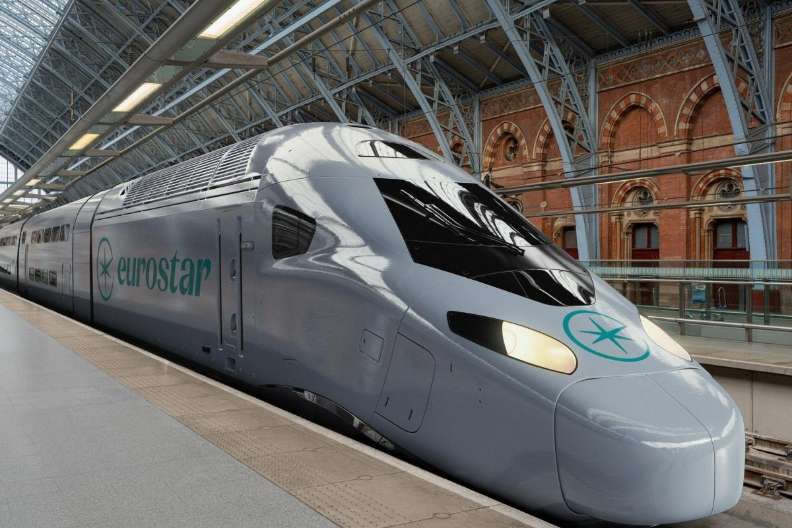

It was announced on 22nd October 2025 that the lines through the Channel Tunnel would see double-decker trains by 2031. An order was placed for their construction and delivery in October 2025.
This article takes a look at the history of double-deck trains and carriages.
The featured image for this article shows what one of these trains would look like in Eurostar’s grey livery. The fully electric fleet of trains will be named Eurostar Celestia, which comes from the Latin word caelestis, meaning ‘heavenly’. The colour of the train has not yet been decided, but the current colour of Eurostar trains is grey, dark blue and yellow. Each train would be 200m long. Currently two are run together making an entire service 400m long. Double-decker trains don’t have twice as many seats as a single-deckers though, just because there needs to be room for interior steps, but there would be a fifth more seats. This means an increase from just under 900 seats on the current service to just over a thousand.

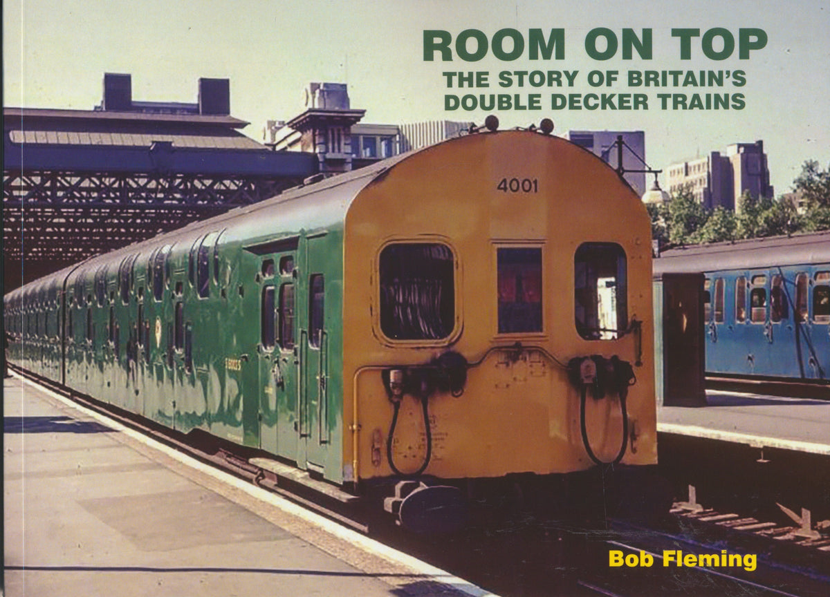

Didn't the UK used to have some double decker trains?
Peter Mugridge
8 Apr 2010
17,808
Epsom
Pretty much a failure in any case. Weren’t boarding times extremely slow.
There's a story that Bulleid knew it wouldn't work but higher powers were insistent on having a double decker built, so he went ahead anyway and made absolutely certain that when it was in use it would be clear to everyone why it wouldn't work.
It's a nice story, but I don't know how much truth there is in it.
Yes, station dwell times were a problem for this stock, however they did run Charing Cross - Dartford services for many years. It was really a bodge job to see if they could avoid the expense of lengthening platforms from 8 to 10 cars to deal with higher usage and they quickly figured that the platform lengthening was needed. I have memories of a unit slowly rotting away at Hoo Junction from the early 80's. I'm not sure if that provided the motor car(?) that is still in existence.
norbitonflyer
24 Mar 2020
5,680
SW London
No point in scrapping them before their time, even if they were non-standard and sub-optimal. They were however outlasted by most of the post-war SUBs
