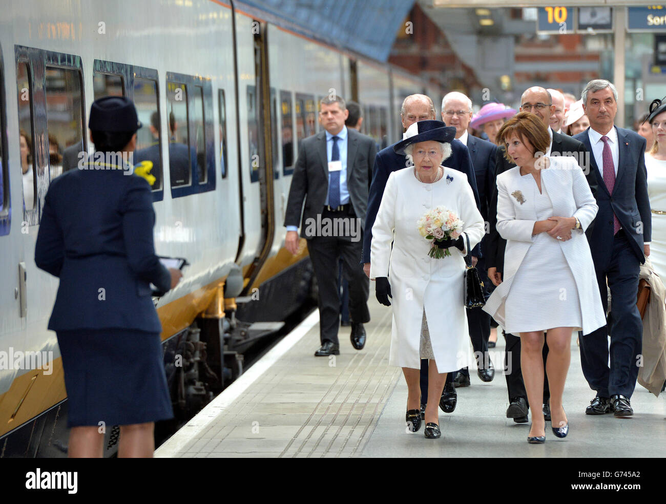

The question really is, was HS1 built to allow proper double-height trains? I'm guessing so (hence the order) but the last double-decked trains were really 1.5 height, not double.
Yes. It's build to full UIC-GC clearance expect for the bit through Ashford (Cleared to UIC-GB+) and any domestic platforms (built to UK profile). HS1 could only run Double-deck trains between the international platforms though, unless somebody designs one with a lower deck of reduced width for St Pancras - Ashford shuttles.
For reference, here is a UK-Gauge Class 373 at St Pancras, note the difference in height from the carriage floor and the extra step needed between the carriage body and the platform.
[image showing class 373 at St Pancras with HM the queen walking toward the camera along the platform]
