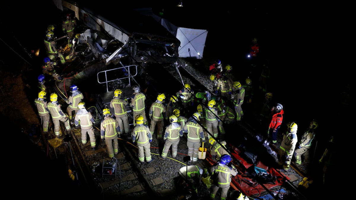

Not a great start to the year for Spain... my condolences to the driver and their relatives.Reports of a derailment near Barcelona just now, due to a failed embankment or retaining wall, with reports the driver has been killed.
A train driver has been killed and at least 15 people injured after a commuter train derailed and crashed near Barcelona, local media report.
According to local officials, the Rodalies train collided with a retaining wall which fell onto the track between Gelida and Sant Sadurní on Tuesday evening.
The severity of injuries suffered by passengers is currently being assessed by emergency services.
A train driver has been killed and at least 14 people injured after a commuter train derailed and crashed near Barcelona, local media report.
Two derailments in Catalunya this evening, retaining wall collapsed onto track as above, plus another with rocks on the line. Torrential rain last few days.Reports of a derailment near Barcelona just now, due to a failed embankment or retaining wall, with reports the driver has been killed.
'In the other incident, a train operating on the R1 line between Blanes and Maçanet stations derailed, though no injuries were reported. The accident was caused by rocks that fell onto the tracks as a result of the storm that battered Girona on Tuesday. Service on that line has also been suspended.'
