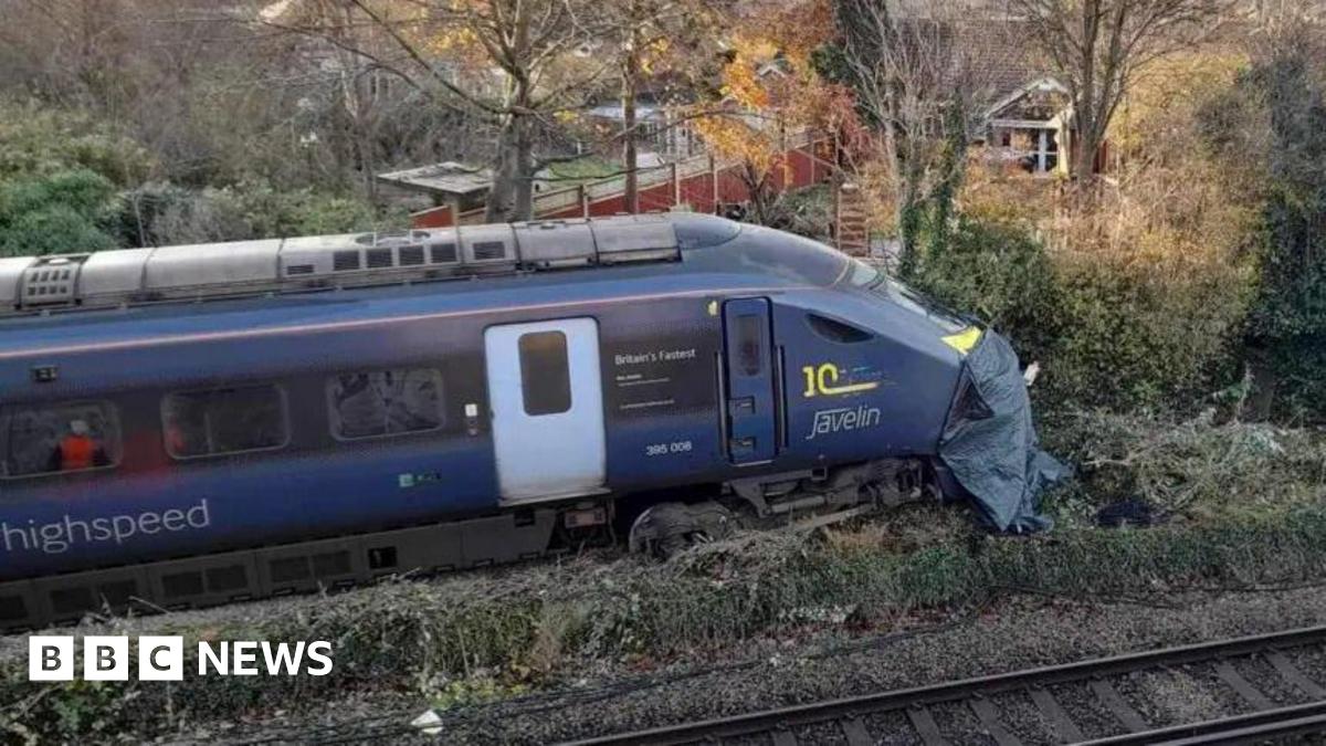

Link to BBC news article about recovery of the derailed 395 being postponed to the new year:
Plans to move a derailed high-speed train have been postponed "into the new year".
The train, which derailed on 28 November, was travelling at a low speed in a siding at Ramsgate railway maintenance depot in Kent, according to Network Rail.
There were no passengers on board and no reported injuries.
A spokesperson for the Southeastern and Network Rail Alliance said: "We have a plan to re-rail and recover the damaged train at Ramsgate; however, given the need to use specialist equipment in order to do so, this will now be rescheduled as soon as possible in the new year."

Thank you for reopening, Steve White the Managing Director of Southeastern has replied to a tweet about this unit,
We are working with Network Rail and contractors to move this unit. It could not be done during the Christmas shut down due to the availability of specialist resources and cannot be removed without closing the railway. We expect the unit to be moved next month.

The replies to that comment are really interesting. I wonder, like one of the replies, why it can’t be hauled out of the siding.
It is off the track for a considerable distance I believe, not helped by a bridge being over head as well.

If it could be dragged out then it would have been as thats was the easiest method of recovery but the leading vehicle is beached in the undergrowth beyond the buffers which will provide a lot of resistance with a risk, albeit small, of the vehicle overturning. Thus it needs a crane to lift it and that can only operate from the adjacent line hence the need for a closure. As i said above this is in SE gift and also NR Kent route are suppose to be in some sort of joined at the hips so you would have thought they would have expedited. Maybe they after a Kirow crane and there all tied up on committed engineering works at weekends currently which is their prime role.

According to my sources, the plan is to drag it out with a road-rail vehicle (RRV) as a tractor, but underframe components beneath the 395 need to be unscrewed or welded off before this can happen. The train is solidly indented into the ground.
Can't use a crane because if you notice the position of the photos and video's, there's a ruddy pedestrian bridge above it!

The latest RAIL edition has a small section on this, with the following report:
The Class 395 Javelin unit that went through the end of a siding in late November is still awaiting removal.
The electric multiple unit (395008) overshot the siding at the western end of Ramsgate maintenance depot on November 28.
A planned recovery on December 28-29 was postponed due to resource constraints, and no new removal date has been arranged.
A Southeastern spokesman told RAIL that to prevent further disruption, the priority is "to try and match the recovery to an existing block in the area."
While the unit remains out of action, three Southeastern services each day run as a single six-carriage train, rather than two units making a 12-car formation.
