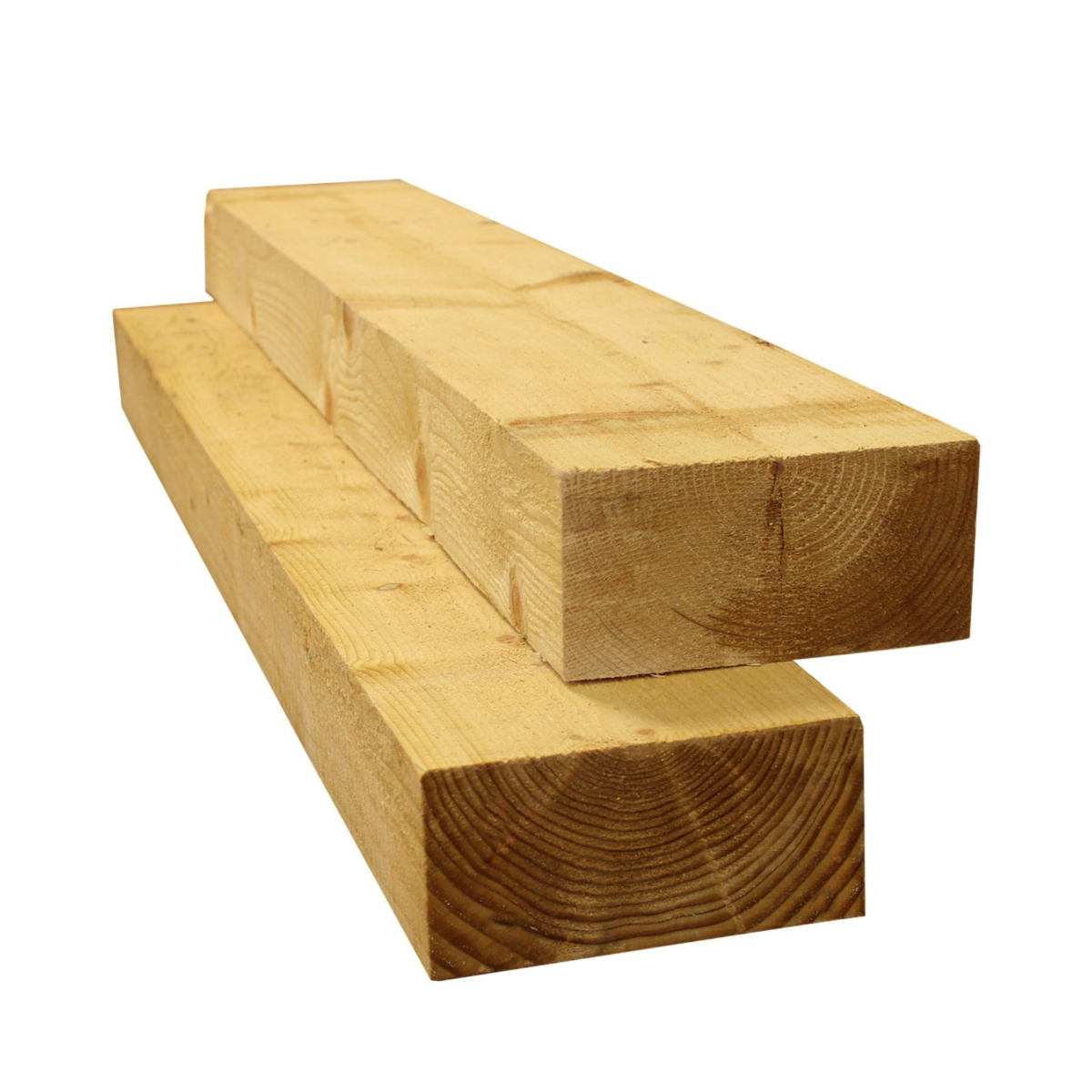

£18.25 from that supplier.
Edit: Ah, a concrete one. Doubt they are sold to the public TBH, they aren't exactly what you'd want in your garden! :)
20 quid for a used one:
