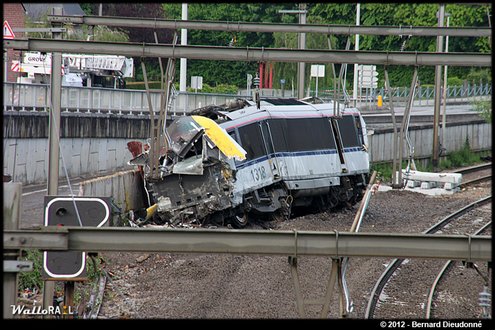

Add to that the Godinne collision in May 2012, which although there were no fatalities, was very destructive in terms of damage to rolling stock.
